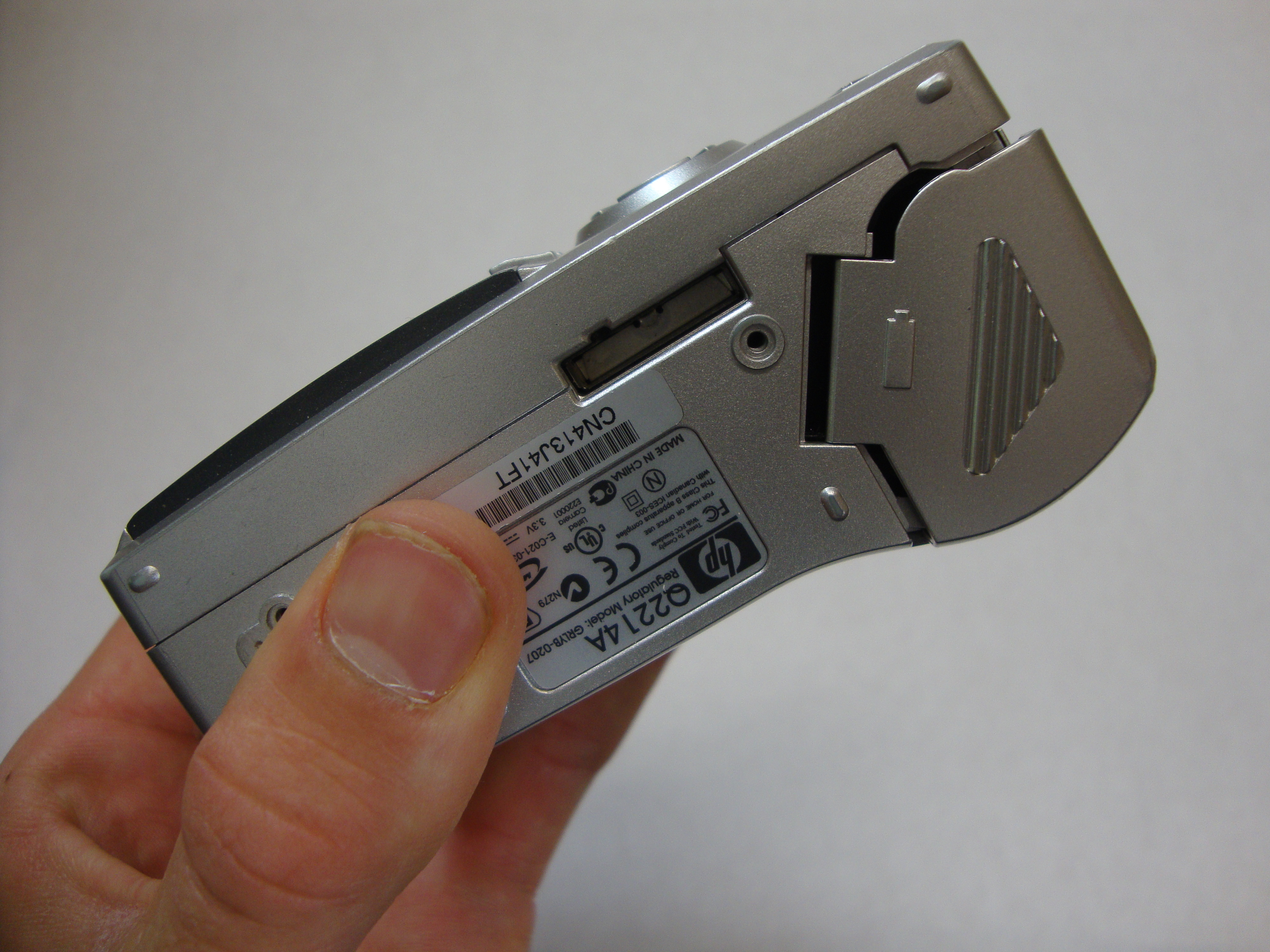

  • Flip the camera over so the bottom is facing you.
Image #1 Image #2
Add Note Edit Step 2  ¶
  • Slid the casing on the bottom right out in the direction of the arrow.

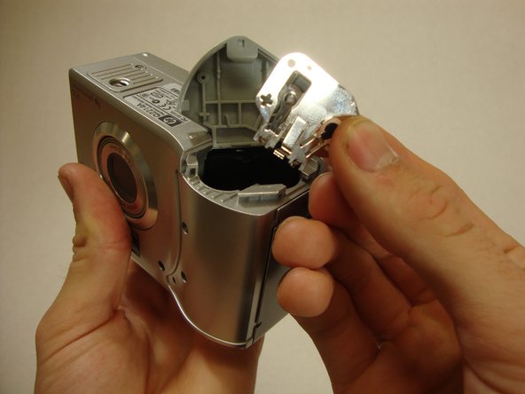

Add Note Edit Step 4 — Internal Battery Circuit Connector  ¶
  • Remove the three screws from the circuit connector.
Image #1
Add Note Edit Step 5  ¶
  • Remove the connector from the battery holder door.
