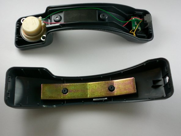

    • Pry the back cover off the headset using a spudger. It is best to pry at the top of the handset.
  4. Inter-tel IP 8660 Handset Microphone and Receiver. Replacement, Handset Microphone and Receiver.: step 4, image 1 of 1
    • While holding the handset front cover, grasp and twist the handset microphone and jack until they come free from the cover.
  5. Inter-tel IP 8660 Handset Microphone and Receiver. Replacement: step 5, image 1 of 3 Inter-tel IP 8660 Handset Microphone and Receiver. Replacement: step 5, image 2 of 3 Inter-tel IP 8660 Handset Microphone and Receiver. Replacement: step 5, image 3 of 3
    • Unscrew the 2 screws (8 mm long) that hold the receiver in place using a #1 Phillips screwdriver.
    • Note: The screws come with washers.
  6. Inter-tel IP 8660 Handset Microphone and Receiver. Replacement: step 6, image 1 of 2 Inter-tel IP 8660 Handset Microphone and Receiver. Replacement: step 6, image 2 of 2
    • Pull the red and green wires that connect the receiver to the microphone out from under the metal piece and black padding.
    • Note: To insert the wires back underneath the black padding, pull the black padding back with your finger and use plastic opening tool to wedge the wires underneath the black padding.
