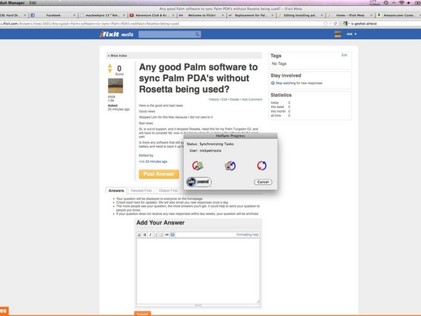

  • Plug the PDA into a computer with Palm Desktop installed to make a backup, if something goes wrong with the repair, or you have to wipe the PDA replacing the battery as it CAN happen
  • If you don't back it up and this does not work, I told you to back it up first
  • If I find a different program to sync these on Intel Macs without Rosetta as an option, I'll let you know, the old software DOES NOT work on modern Macs because it needs Rosetta, and the new software won't sync these PDA's, Palm Desktop is coming to an end to sync these

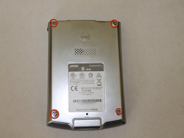

  • Remove 4 T5 Torx screws from the back of the PDA and remove the back with you fingernails or pry tools
  • the battery is taped to the back cover of this PDA, so do not remove it all the way
