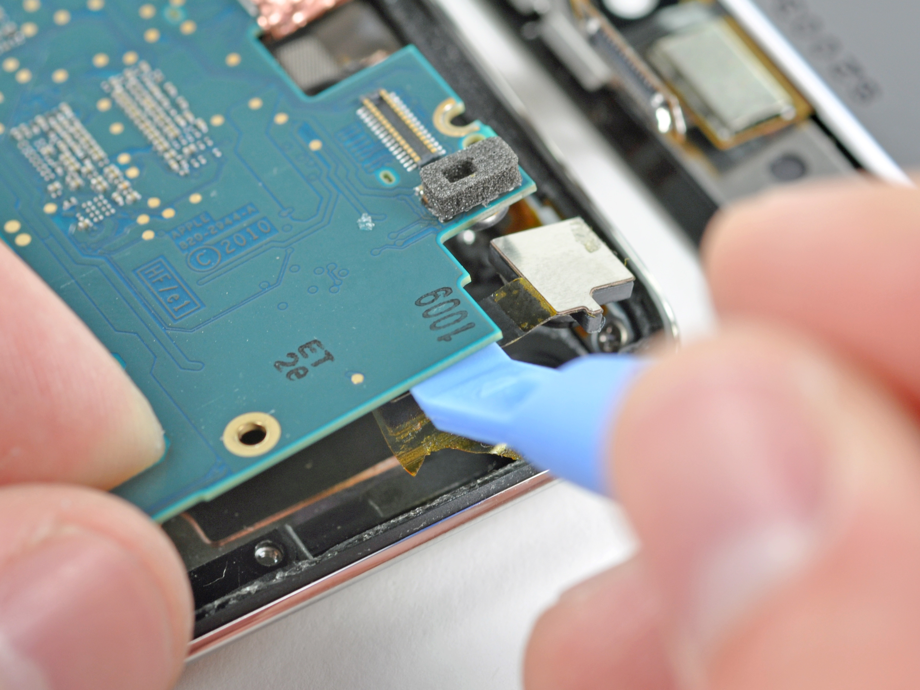

    • Use an iPod opening tool to peel the edge of the yellow kapton tape that covers the rear-facing camera and the logic board.
    • Continue peeling the tape from the bottom of the rear-facing camera connector.
    • Use a pair of tweezers to grasp and remove the tape from the top of the rear-facing camera connector.
  13. iPod Touch 4th Generation Rear-Facing Camera Replacement: step 13, image 1 of 2 iPod Touch 4th Generation Rear-Facing Camera Replacement: step 13, image 2 of 2
    • Use the edge of an iPod opening tool to pry the rear-facing camera connector away from its socket on the logic board.
    • Remove the rear-facing camera from the Touch.
