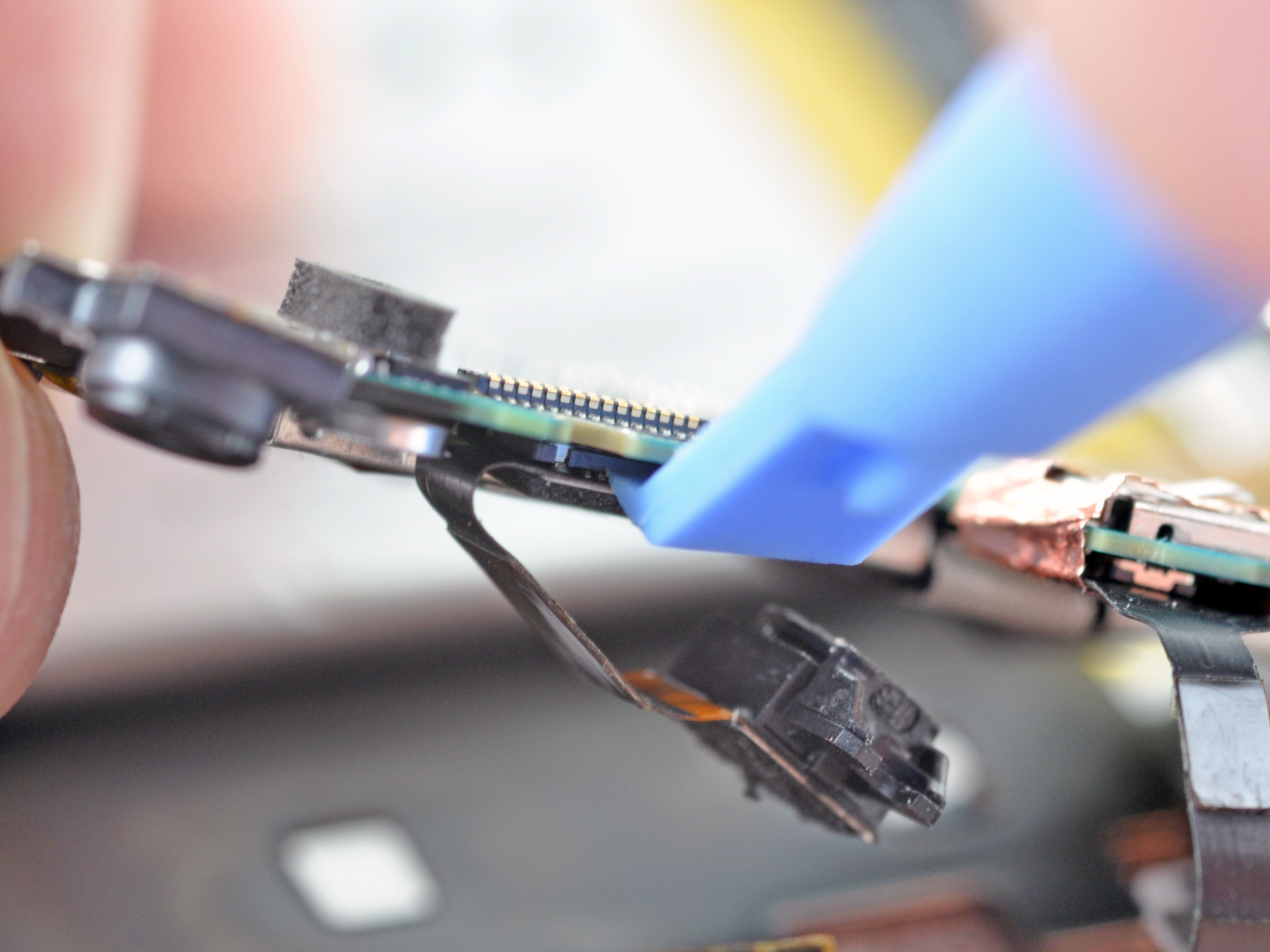

  12. iPod Touch 4th Generation Front-Facing Camera Replacement, Front-Facing Camera: step 12, image 1 of 1
    • While gently lifting the top edge of the logic board, use an iPod opening tool to pry the front-facing camera connector out of its socket on the logic board.
    • Remove the front-facing camera from the Touch.
