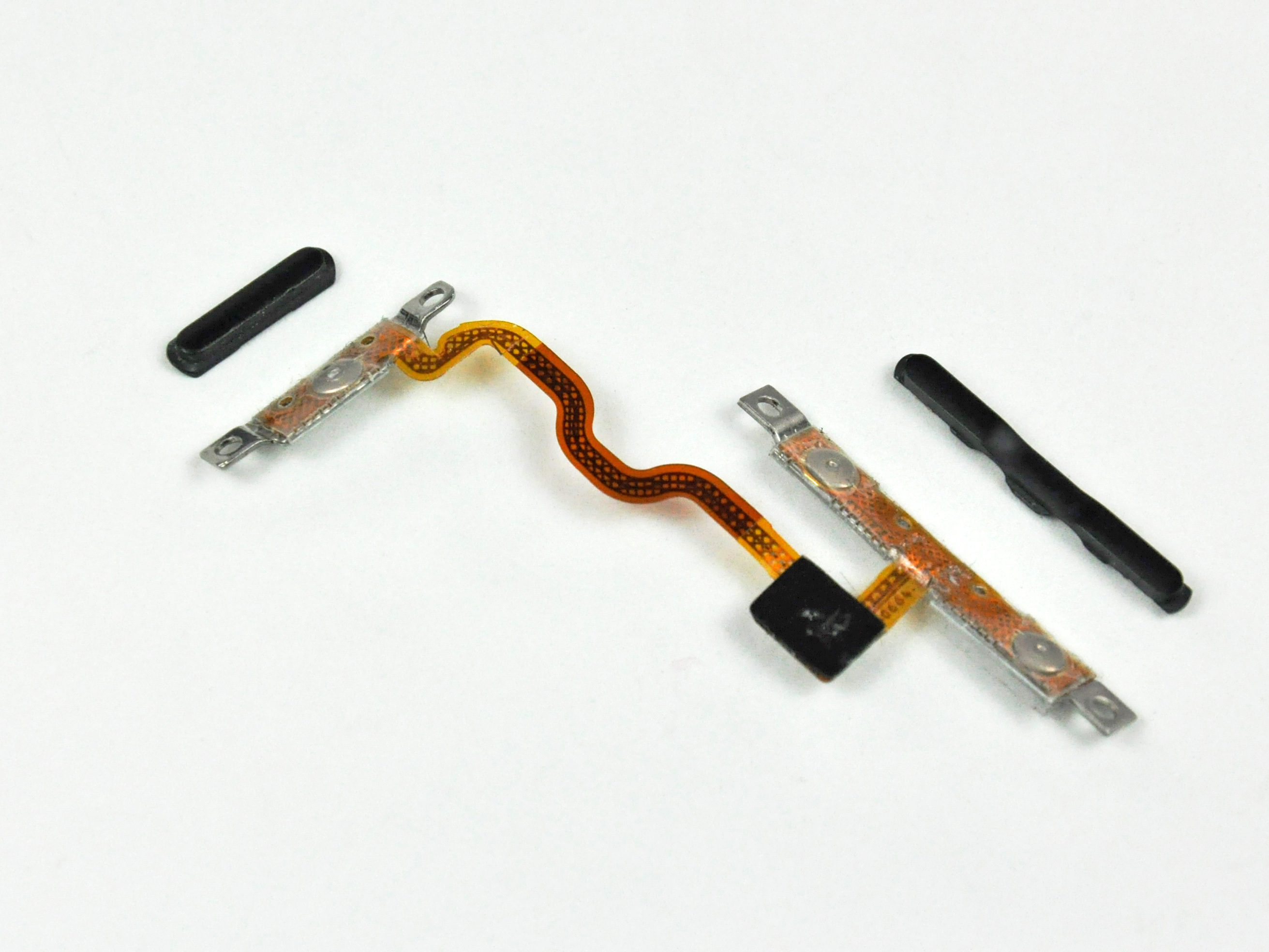

Installing iPod Touch 3rd Generation Power/Volume Controls Replacement
Replace the power and volume controls.
- Author: Andrew Bookholt
- Difficulty: Moderate
Use this guide to replace the electronic portion of the power and volume controls as well as the plastic buttons on the exterior of the device.
