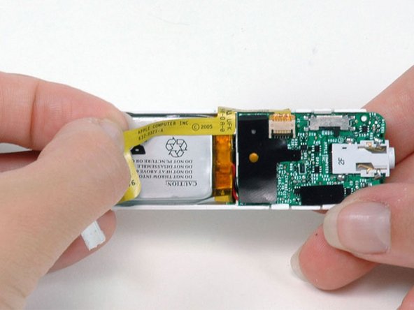

Image #1
Add Note Edit Step 11  ¶
  • Carefully peel the yellow USB ribbon up from the battery.
Image #1
Add Note Edit Step 12  ¶
  • Slide the USB ribbon out of its connector.
  • Lift the USB port and attached ribbon cable out of the iPod.

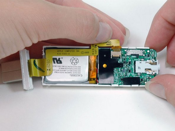

Image #1
Add Note Edit Step 13 — Battery & Logic Board  ¶
  • Gently pull back the white plastic framework to free the left edge of the logic board. Pull up on the logic board slightly to prevent the logic board from falling back into place.
Image #1
Add Note Edit Step 14  ¶
  • Repeat the same procedure on the opposite side to free the logic board from the white plastic casing.

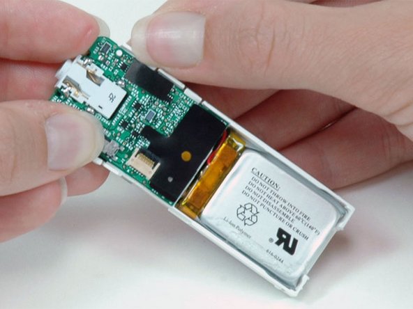

Image #1
Add Note Edit Step 15  ¶
  • Lift the logic board up to disconnect it from the memory board beneath. Don't remove the logic board from the iPod yet, because it's still connected to the battery.

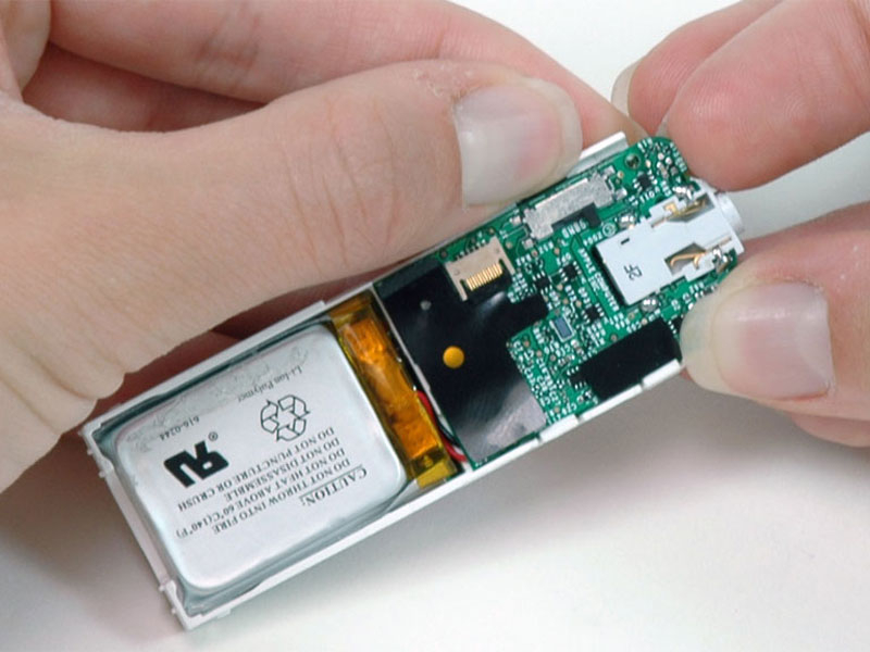

Image #1
Add Note Edit Step 16  ¶
  • Turn the iPod over and use your finger to push the battery through the hole in the casing. The battery is attached to the plastic framework with a mild adhesive.
  • Lift the battery and logic board out of the iPod.
