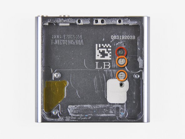

Add Note Edit Step 16 — Outer Case  ¶
  • Remove the following three screws:
    • One black 1.8 mm Phillips screw
    • Two 1.7 mm Phillips screws
