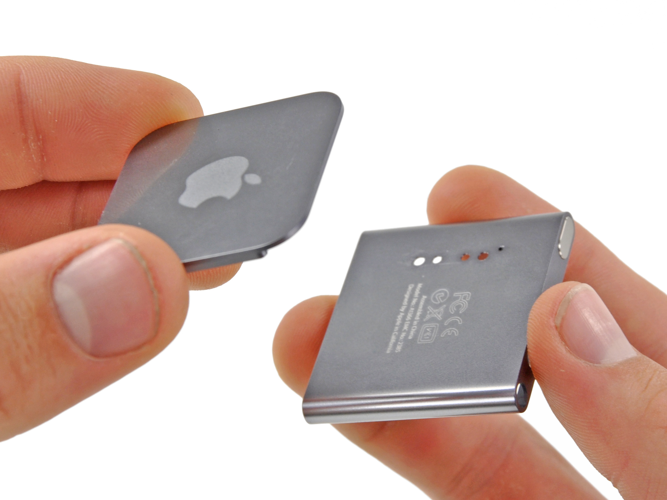

Installing iPod Nano 6th Generation Outer Case
Replace the aluminum outer casing on your 6th generation iPod Nano.
Use this guide to replace your iPod Nano's outer casing.
