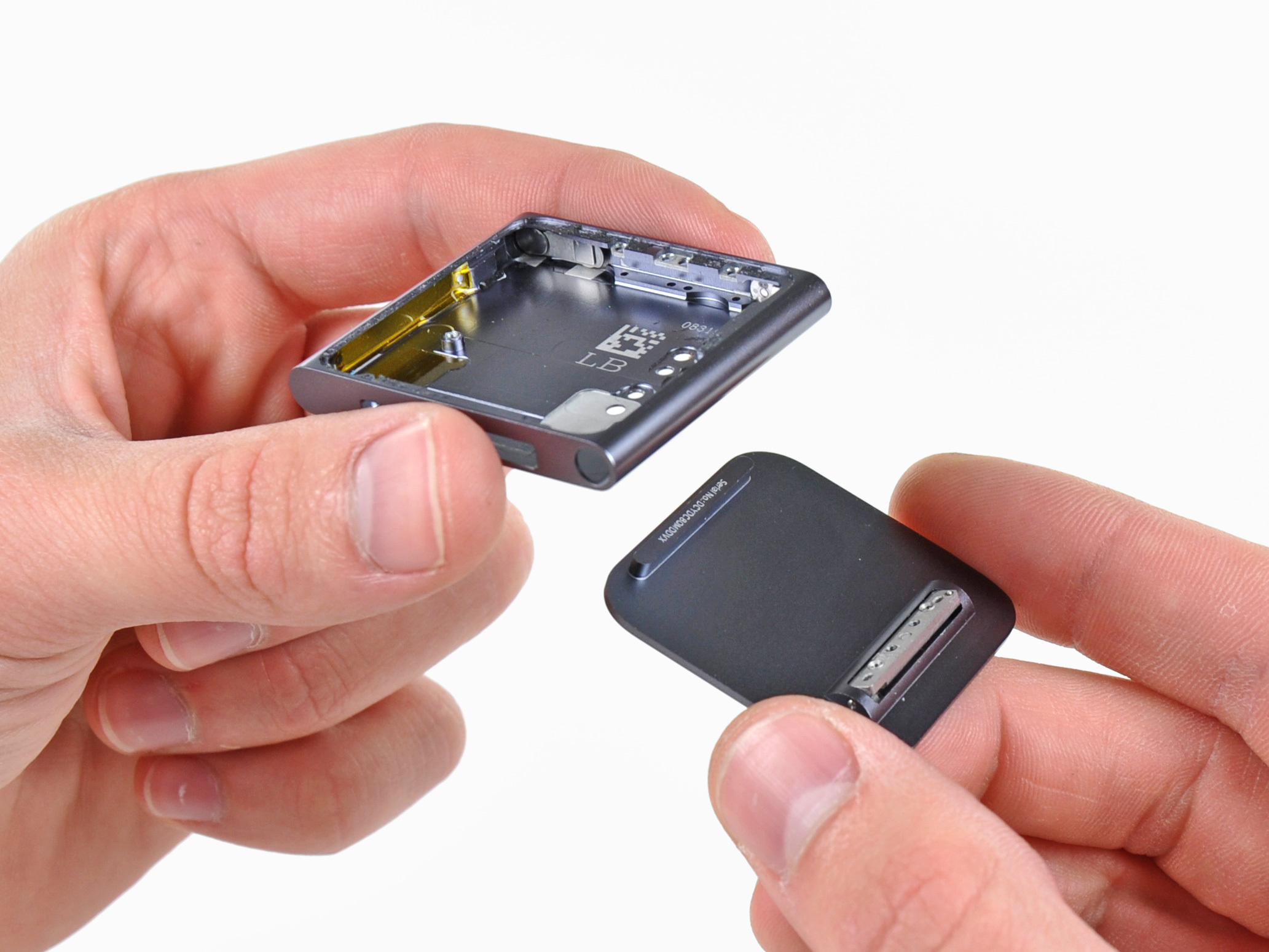

  16. iPod Nano 6th Generation Clip Replacement, Clip: step 16, image 1 of 1
    • Remove the following three screws:
    • One black 1.8 mm Phillips screw
    • Two 1.7 mm Phillips screws
  17. iPod Nano 6th Generation Clip Replacement: step 17, image 1 of 1
    • Remove the clip from the outer case.
    • When reinstalling the clip, it is necessary to squeeze the base of the clip very tightly against the outer case as you insert the first screw.
