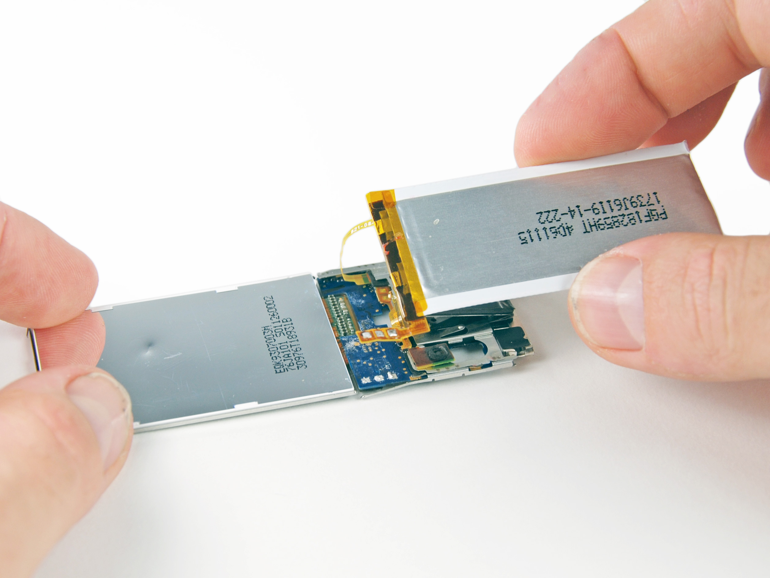

  • Repeat the previous step for the two remaining solder pads, working from right to left.
  • Once the three connections have been desoldered, lift the old battery off the logic board.
