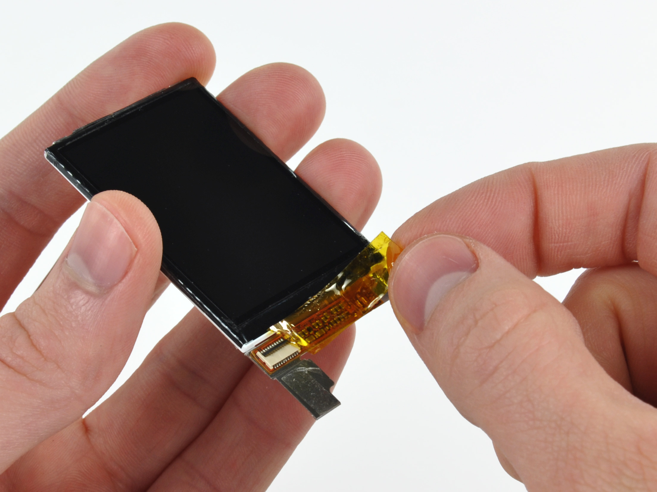

Use this guide to replace your Nano's display.
With the HTML code below, you can embed this guide as a small widget on your website.
Insert the edge of an iPod opening tool into the gap between the outer case and the top bezel.
Pry the top bezel off the adhesive securing it to the display retainer.
At this point the hold switch slider is free and may fall. Be careful not to lose it.
Remove the hold switch slider from the top of the Nano.
Remove the two angled Phillips screws from the two corners of the display retainer.
These screw heads are extremely small and easily stripped.
