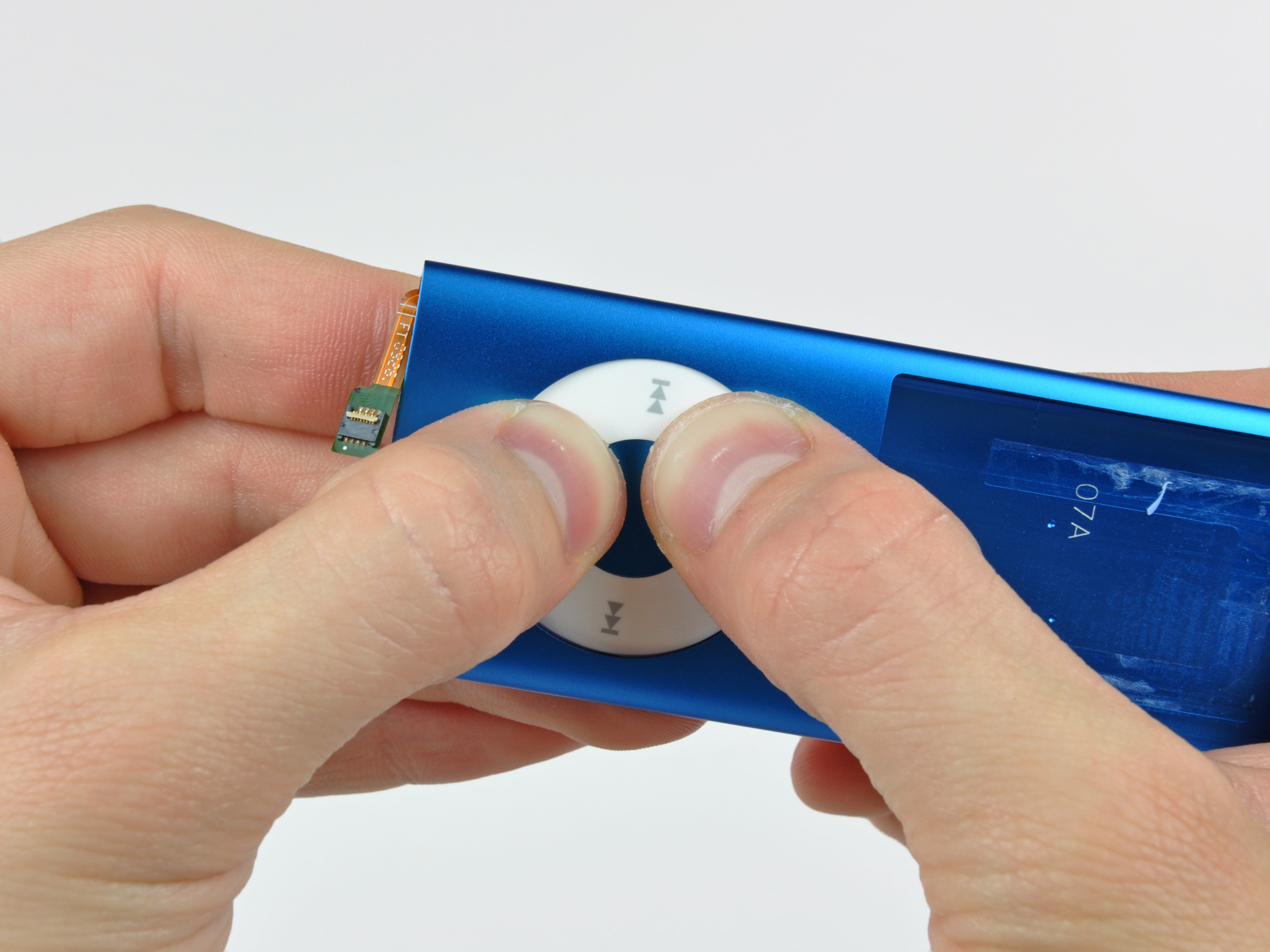

  21. iPod Nano 4th Generation Click Wheel Replacement, Click Wheel: step 21, image 1 of 2 iPod Nano 4th Generation Click Wheel Replacement, Click Wheel: step 21, image 2 of 2
    • Press down firmly around the perimeter of the click wheel to separate it from the adhesive securing it to the outer case.
    • This requires a good amount of force. Work slowly.
    • It may be helpful to use an edged tool to separate the adhesive from the click wheel on the inside of the Nano while pressing it down from the outside.
    • Remove the click wheel from the inside of the Nano.
    • Be careful not to let the click-wheel slide on the metal plate supporting it, as it will break the flat cable. Apply force perpendicular to the click-wheel.
