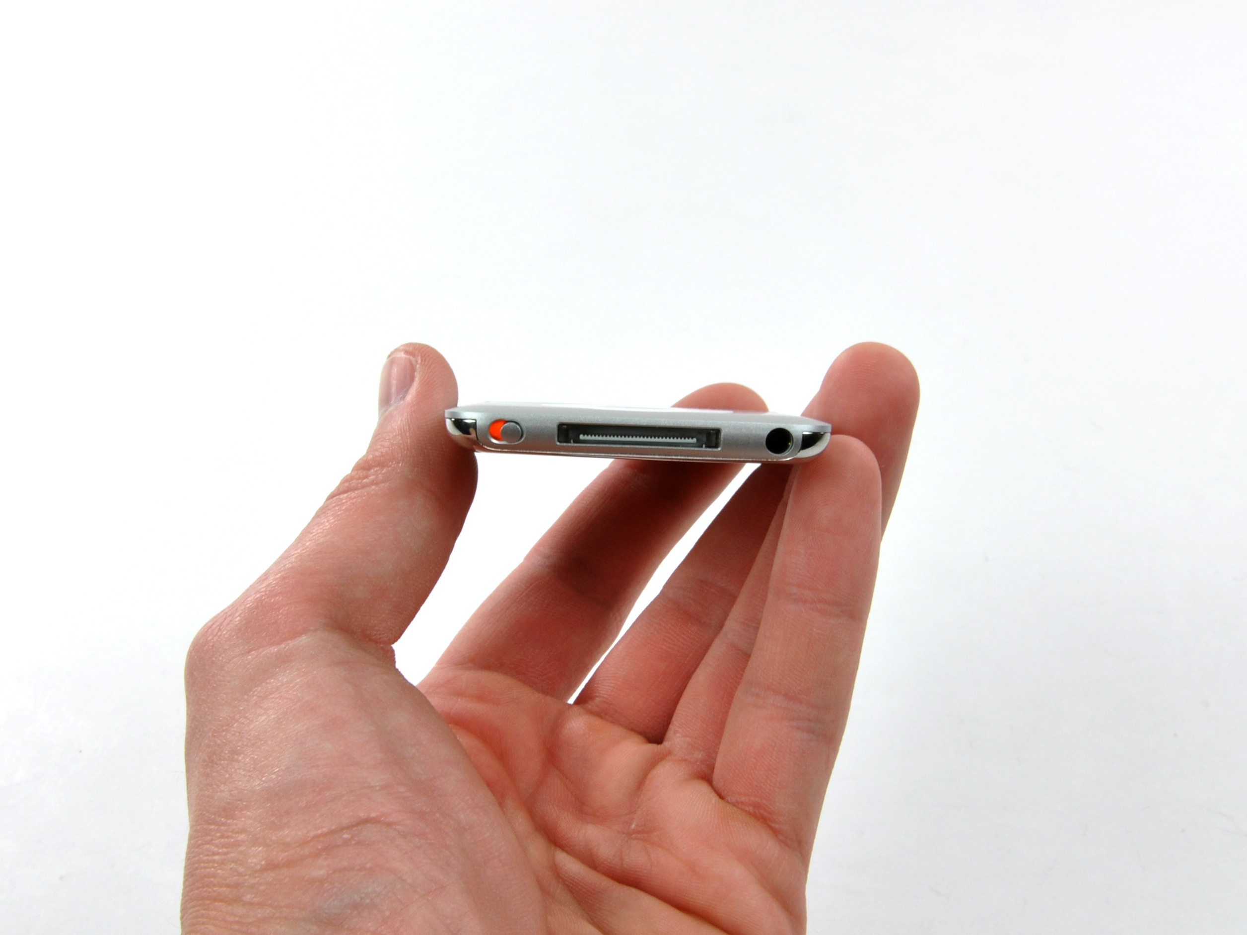

Add Note Edit Step 1 — Rear Panel  ¶
  • Please be aware that removing the rear panel from the back of the iPod will cause considerable damage to the rear panel. We highly recommend purchasing an additional rear panel to properly reassemble the iPod.
  • Before opening your iPod, ensure that the hold switch is in the locked position.
