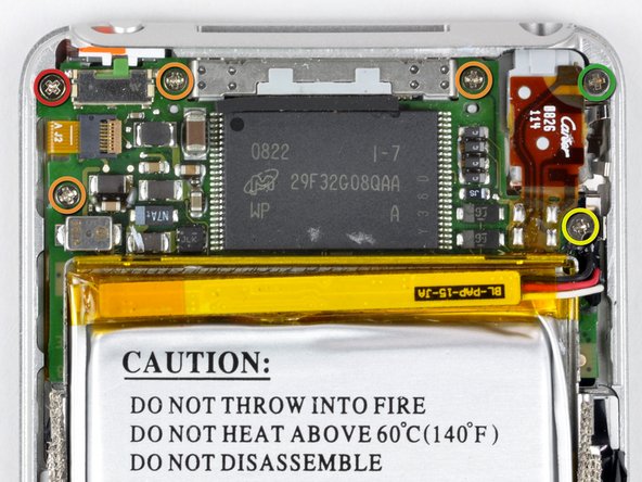

Add Note Edit Step 8  ¶
  • Remove the following six screws:
    • One 1.8 mm Phillips.
    • Three 1.9 mm Phillips.
    • One 2.4 mm Phillips.
    • One 2.6 mm Phillips.
first image
thumb image 1
thumb image 2
