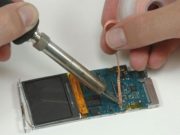

Add Note Edit Step 17  ¶

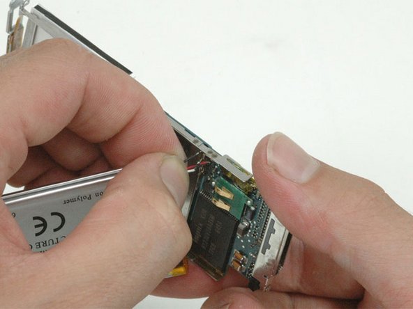

  • Place the desoldering wick on top of the existing solder ball.
  • Place the soldering iron on top of wick above the existing solder ball.
  • Hold the soldering iron in place until the solder melts into the wick.
  • Repeat the same procedure on the remaining two connectors.
Image #1

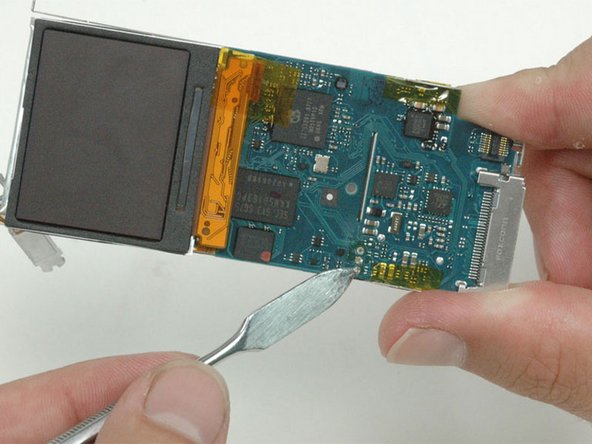

Add Note Edit Step 18  ¶
  • Be careful not to scrape the metal rings surrounding the connectors off the logic board. If you accidentally scrape these off, you won't be able to reconnect the replacement battery.
  • Use a metal spudger to carefully straighten the battery wires. Be sure to only touch one contact at a time.
Image #1
Add Note Edit Step 19  ¶
  • Pull the battery wires through the logic board to free the battery. If the wires don't easily come free, make sure the wires are straight and all the solder has been removed.

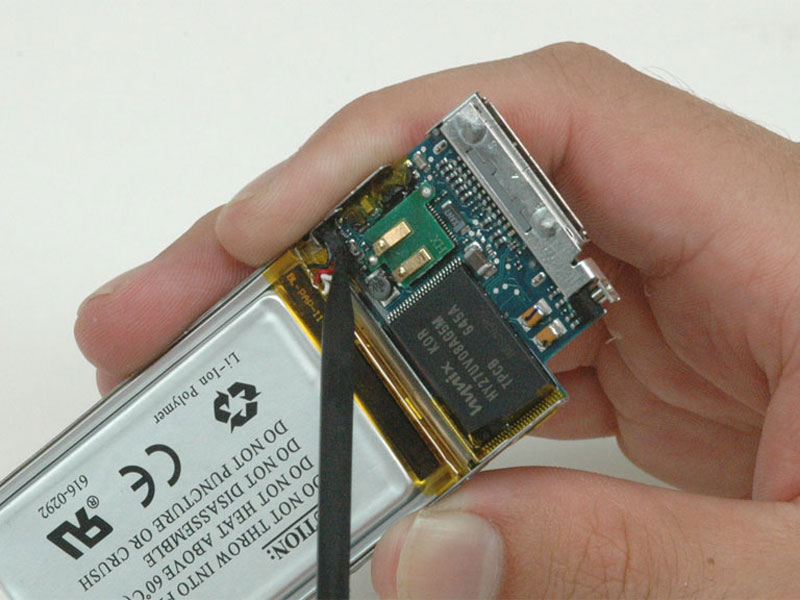

Image #1

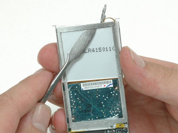

Add Note Edit Step 20  ¶
  • Use a metal spudger to carefully pry the metal bracket off the back of the display. Make sure you only pry off the bracket and not the clear shielding on the rear of the display. By working from the inside of the display, you won't be able to accidentally pry up the clear plastic shielding.

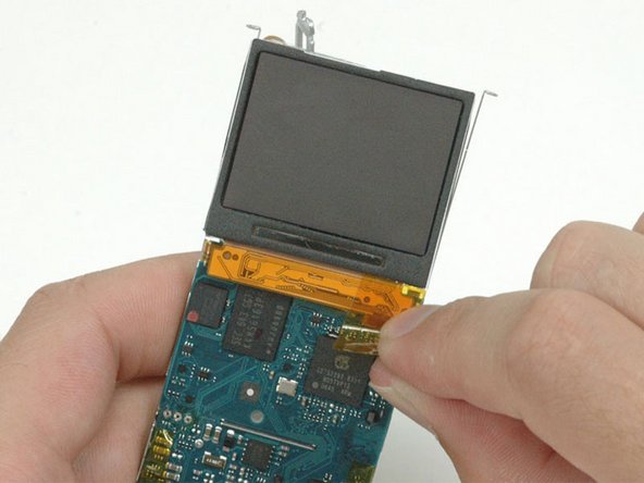

  • Peel up the orange tape covering the display ribbon cable.
Image #1

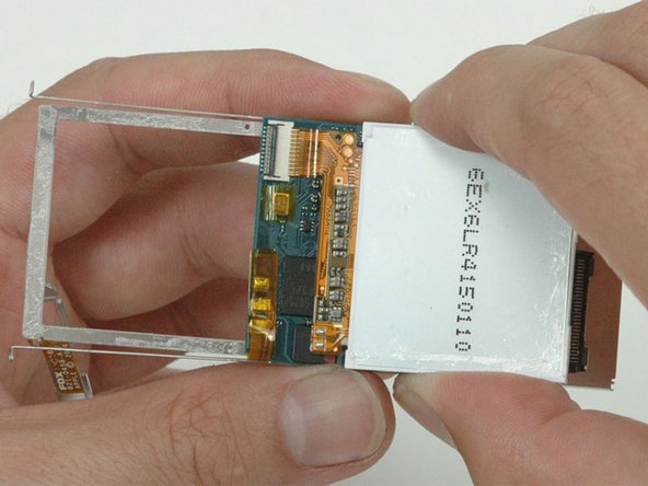

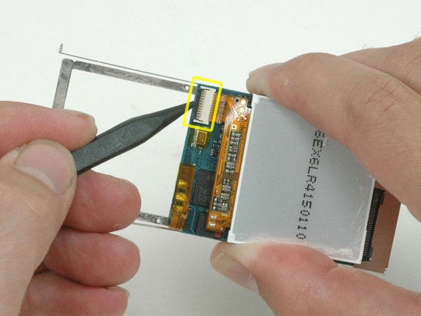

Add Note Edit Step 22  ¶
  • Use a spudger to flip up the black plastic tab holding the orange display ribbon in place. The tab will rotate up 90 degrees, releasing the ribbon cable.
Image #1
Add Note Edit Step 23  ¶
  • Slide the display ribbon out of its connector and lift the display off of the logic board.

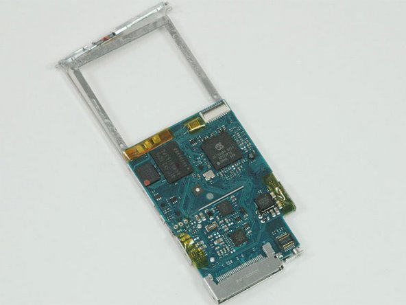

Image #1
Add Note Edit Step 24  ¶
  • Logic board remains.
