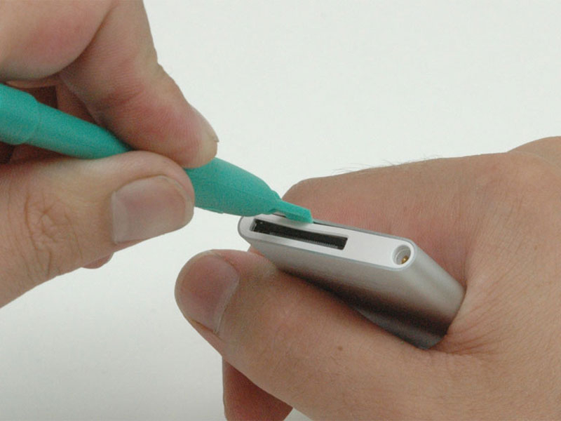

  • Before opening your iPod, ensure that the hold switch is in the locked position.
first image
Add Note Edit Step 2  ¶
  • When removing the the bottom bezel, be sure not to bend the plastic surrounding the dock connector.
  • Carefully insert an iPod opening tool in the seam between the metal casing and white plastic bezel
  • Lift the bottom bezel off the iPod. It's glued on using a mild adhesive, so some force may be required.
