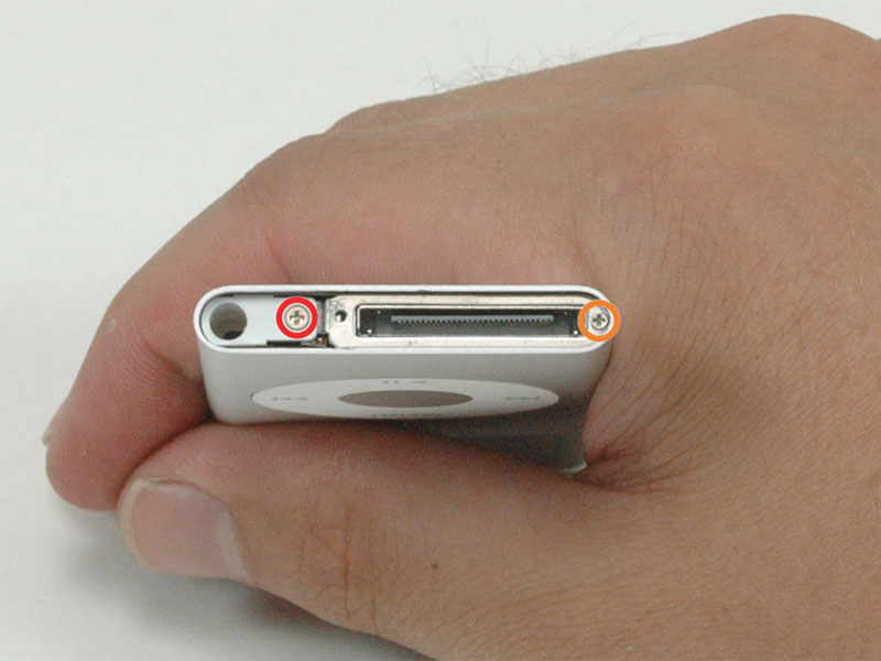

Add Note Edit Step 3 — Bottom Bezel Bracket  ¶
  • Remove the following two screws:
    • One #00 Phillips screw with a large head near the headphone jack.
    • One #00 Phillips screw with a smaller head near the side of the iPod. This screw strips easily, so be sure to press down firmly on the screwdriver.

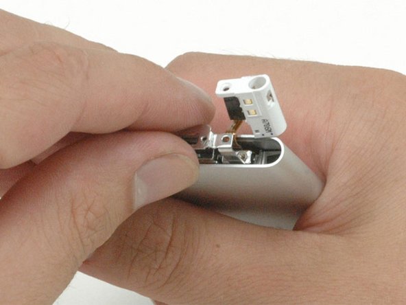

Add Note Edit Step 5  ¶
  • Slide the headphone jack out until the white plastic housing is no longer held in place by the metal casing.
first image

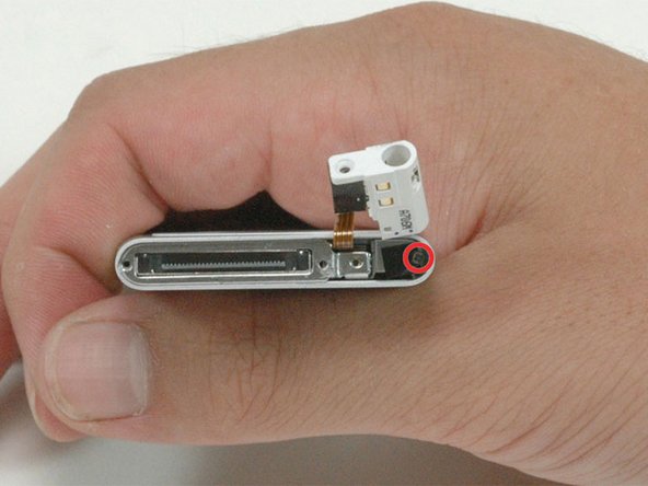

Add Note Edit Step 6  ¶
  • Remove the newly-revealed Phillips #00 screw from beneath the headphone jack.
first image
Add Note Edit Step 7  ¶
  • Lift the bottom bezel bracket out of the iPod.
