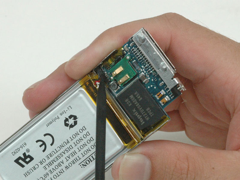

Add Note Edit Step 14 — Battery  ¶
  • Use a spudger to scrape away the black glue covering the three battery wires.
first image
