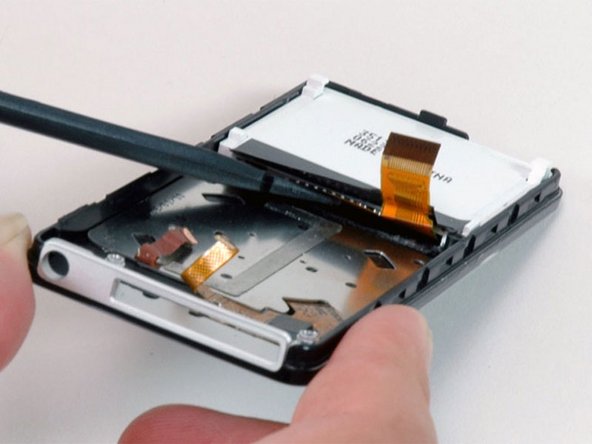

Add Note Edit Step 18 — Display  ¶
  • Use a spudger to carefully pry up the adhesive holding down the edge of the display.
  • Be careful not to slide the spudger in too far to prevent scratching the display.

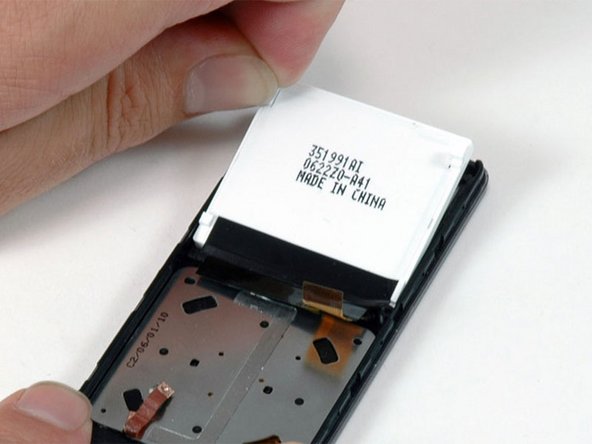

Add Note Edit Step 19  ¶
  • Gently lift up on one corner of the display to separate the adhesive holding the display in place.
  • Lift up on the other corner of the display in the same manner.

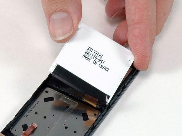

Add Note Edit Step 20  ¶
  • Lift the display up and out of the iPod.
Image #1
Add Note Edit Step 21  ¶
  • The display is now free from the iPod.
