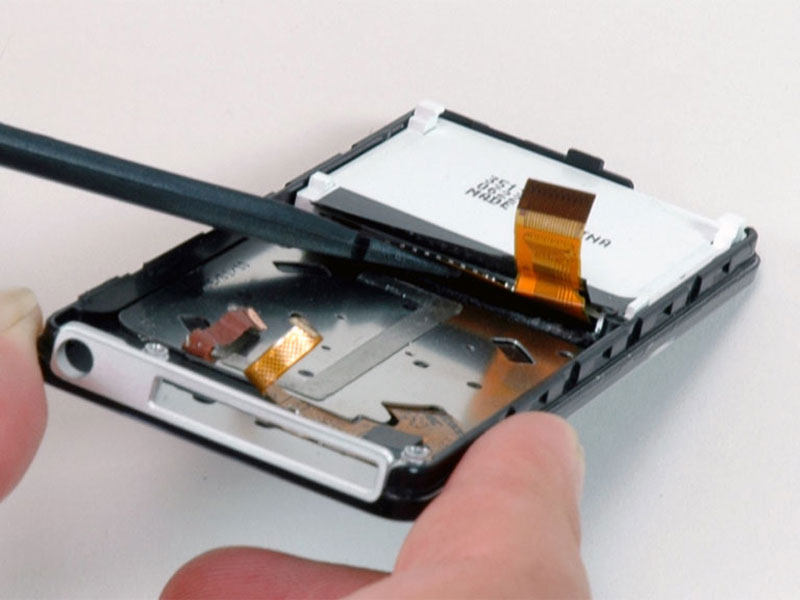

  • Disconnecting the following two ribbon cables may be challenging. To prevent straining the cables or connectors, you can only separate the two halves of the iPod about 1/2 inch during the process.
  • Use a spudger to flip up the black plastic tab holding the orange display ribbon in place. The black tab will rotate up 90 degrees, releasing the ribbon cable.
Image #1
Add Note Edit Step 14  ¶
  • Use a spudger to slide the display ribbon out of its connector.
Image #1
Add Note Edit Step 15  ¶
  • Use a spudger to flip up the black plastic tab holding the orange click wheel ribbon in place. The black tab will rotate up 90 degrees, releasing the ribbon cable.
Image #1
Add Note Edit Step 16  ¶
  • Use a spudger to slide the click wheel ribbon out of its connector.
