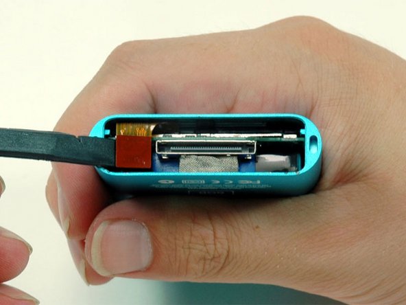

Add Note Edit Step 4 — Bottom Bezel  ¶
  • Carefully insert a small flathead screwdriver in the seam between the metal casing and white plastic bottom Use the screwdriver to pry up the white plastic bottom bezel. Be careful not to damage the soft plastic with your screwdriver.
first image
Add Note Edit Step 5  ¶
  • A small pair of snap ring pliers is the easiest tool to remove the metal retaining bracket.
  • You can also use a flathead screwdriver to pry out the metal retaining bracket beneath the bottom bezel as shown. You can free the bracket by first pushing in the metal arms on the corners and then lifting the bracket.

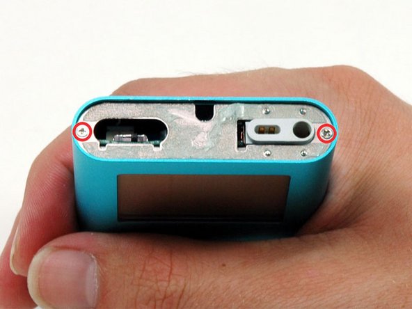

Add Note Edit Step 8  ¶
  • Remove the two #00 Phillips screws securing the headphone jack to the casing.

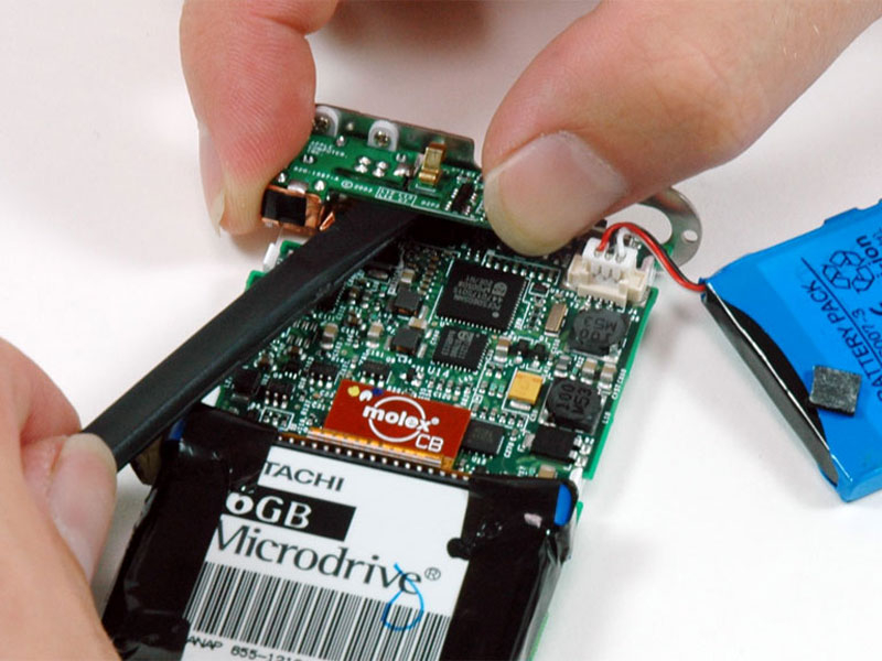

Add Note Edit Step 12  ¶
  • Use a spudger to carefully pry up the headphone jack board from the logic board. Be careful to pry up near the connector to prevent unnecessary strain on the board.
  • Lift the headphone jack board off of the logic board.
