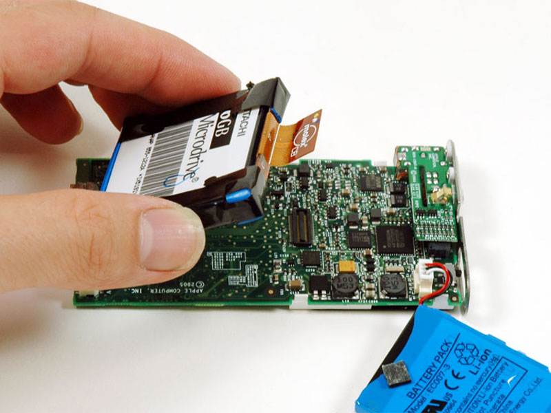

Add Note Edit Step 12  ¶
  • Use a spudger or the tip of your finger to carefully disconect the orange hard drive ribbon from the logic board.
first image
Add Note Edit Step 13  ¶
  • Lift the hard drive out of the iPod.
