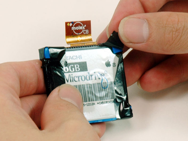

Add Note Edit Step 14 — Hard Drive Cable  ¶
  • Peel back the black tape securing the two blue bumpers to the hard drive near the orange ribbon cable.
first image
Add Note Edit Step 15  ¶
  • Slide the two blue bumpers off the corners of the hard drive. There is no need to remove these bumpers entirely.
first image
Add Note Edit Step 16  ¶
  • Carefully disconnect the orange hard drive ribbon cable from the hard drive. Be sure to apply even pressure while pulling to prevent any bent pins.
  • If the cable doesn't come free easily, you may be able to free it by gently rocking the ribbon cable back and forth.
