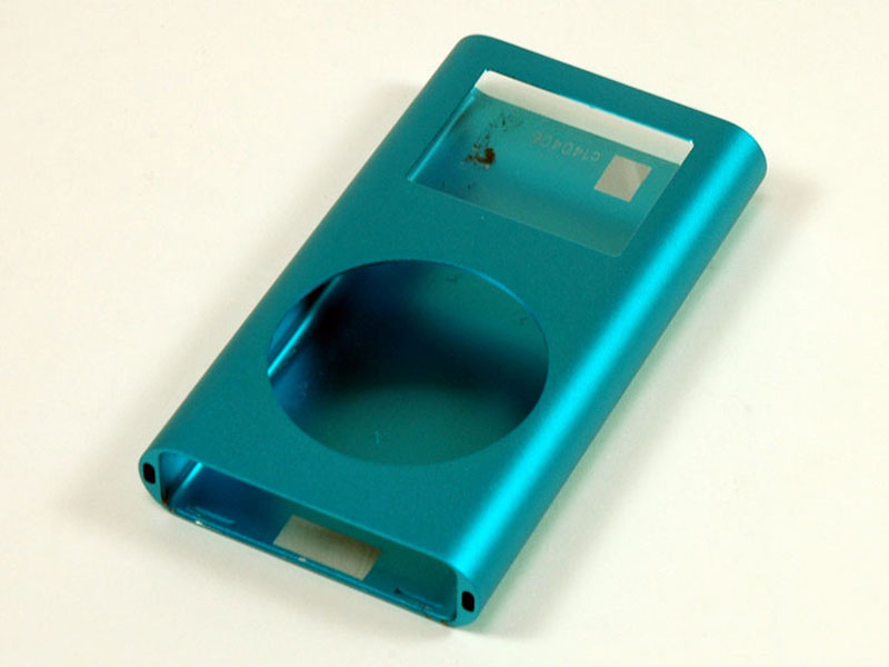

Installing iPod Mini Casing
  • Author: iRobot
  • Difficulty: Moderate
  • Add Note x
  • x 11
The colored metal casing.

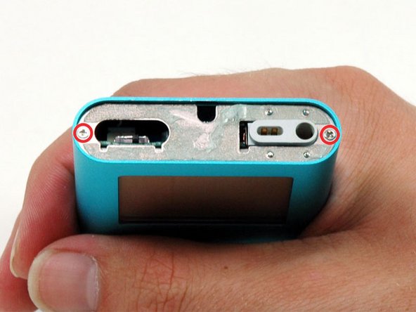

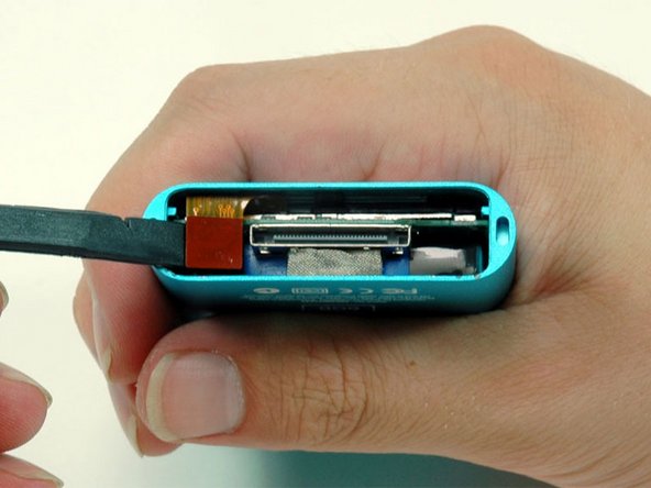

Add Note Edit Step 7 — Casing  ¶
  • Use a spudger or the tip of your finger to carefully disconect the orange click wheel ribbon from the logic board.
Image #1
Add Note Edit Step 8  ¶
  • Remove the two #00 Phillips screws securing the headphone jack to the casing.
