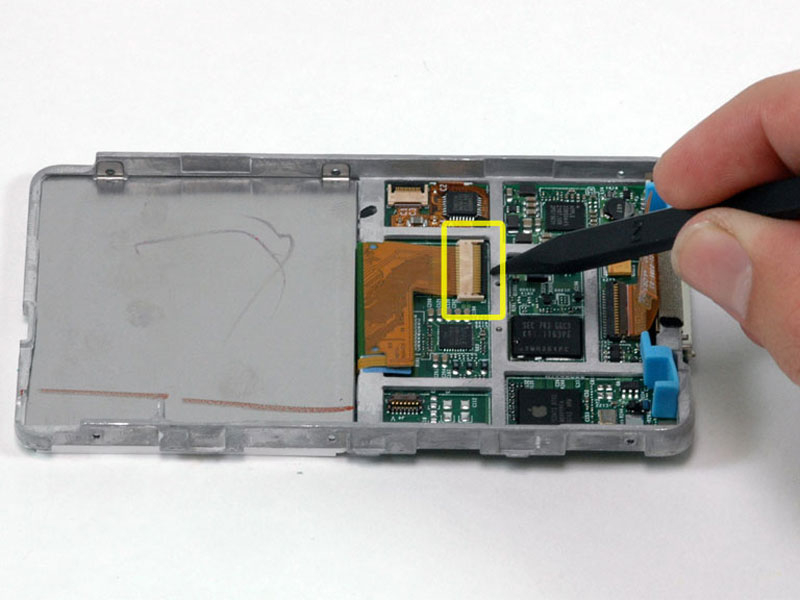

Add Note Edit Step 31 — Logic Board  ¶
  • Use a spudger to flip up the plastic tab holding the orange display ribbon in place. The tab will rotate up 90 degrees towards the display, releasing the ribbon cable.
first image
Add Note Edit Step 32  ¶
  • Slide the orange display ribbon cable directly out of its connector.
