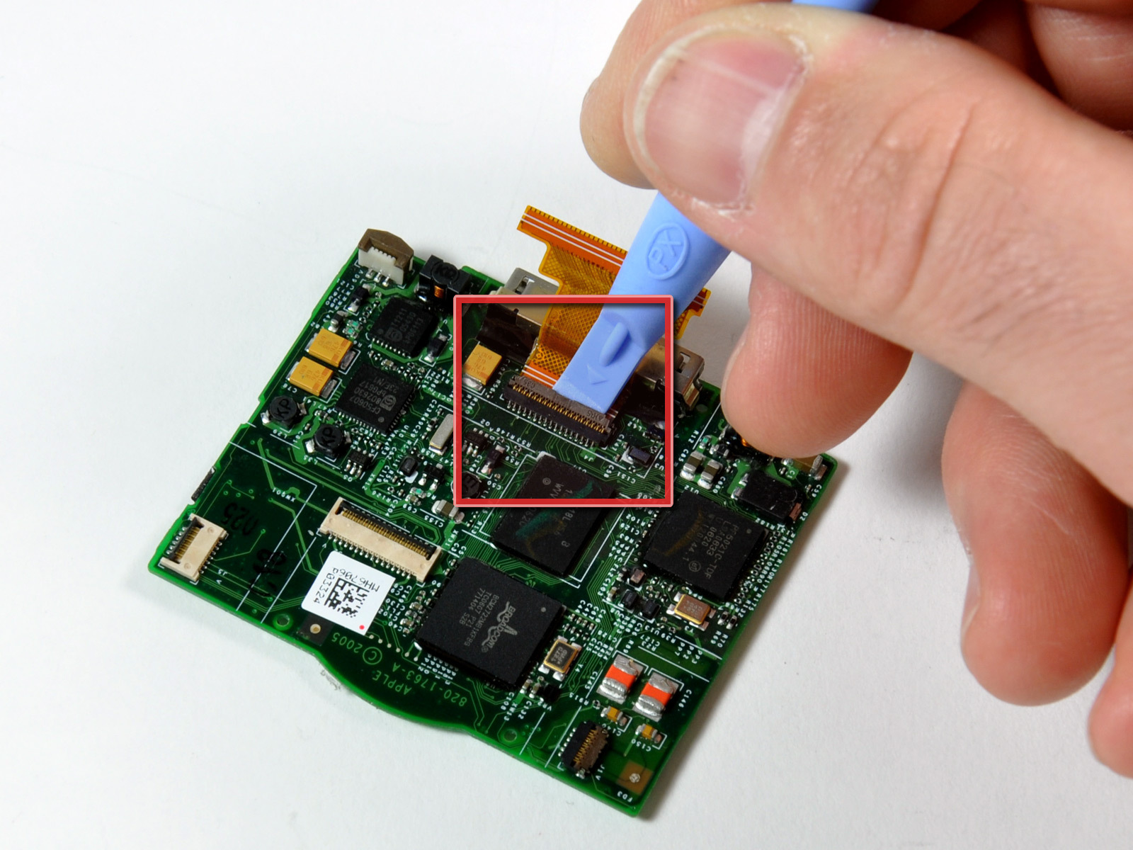

Add Note Edit Step 7  ¶
  • You should now have one orange ribbon cable still attaching the front case to the back.
  • At this point you are able to remove and replace the blue rubber bumpers, or continue with separating the case.
Image #1
Add Note Edit Step 8  ¶
  • Lift up the hard drive to expose the headphone jack ribbon connector (indicated by the yellow box).
  • If the hard drive bumpers come loose, make sure to put them back with the notch as shown in the picture.
