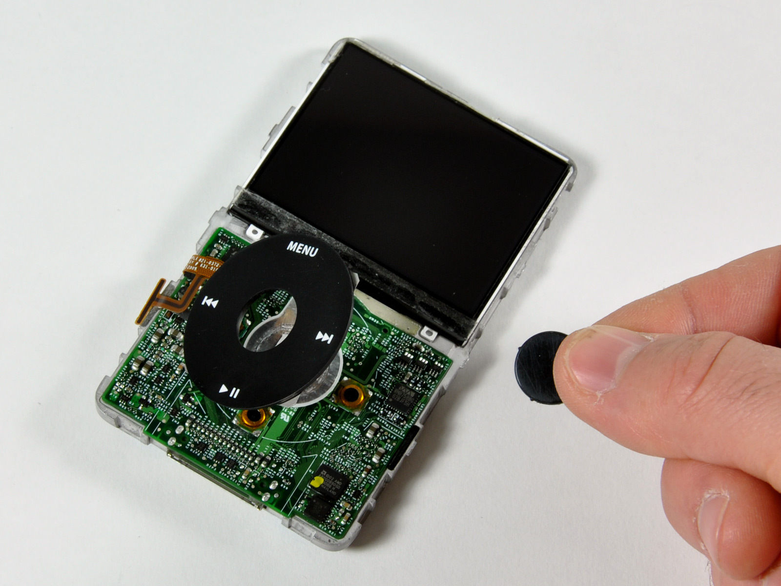

Installing iPod 5th Generation (Video) Click Wheel Button
- Author: Miroslav Djuric
- Difficulty: Moderate
This guide shows how to remove the click wheel button from an iPod Video.
- View:
- Single page
Edit
Step 2
Opening the iPod can be challenging. Do not get discouraged if it takes you a few tries before the iPod is opened.
Free the first retainer clip on the bottom of the iPod using the iPod opening tool. The tool's edge should point towards the metal back case to prevent scratching the plastic front.
Edit
Step 4
There are four retaining clips on each side of the iPod. An iPod opening tool will be used to separate the plastic front from the metal back of the iPod.
Insert the iPod opening tool into the left side of the iPod, with the edge of the tool pointing towards the metal back.
Gently enlarge the existing crevice by wiggling the iPod opening tool and moving it to the left.
Continue doing so until the entire side of the iPod is loose.
You can then insert an iPod opening tool to the right of the Hold button. Be very careful while inserting the tool, as the display is very fragile.
Edit
Step 5
Gently glide the iPod opening tool on the top of the display, making sure to free the retaining clips.
The other sides of the iPod should now easily come loose. If they do not, use iPod opening tools on the right side of the iPod in the same way as on the left side of the iPod.
Separate the front of the iPod from the back about an inch (or a couple of centimeters).
The iPod casing is now open, but don't completely separate the two halves just yet. Two ribbon cables are still connecting the back panel to the rest of the iPod.
Edit
Step 6
Use angled tweezers or an iPod opening tool to slide up the brown connector latch, holding the orange battery ribbon cable in place. Make sure you pull from both sides of the latch. You only need to lift the brown connector latch up about 1-2mm to free the cable. Do not lift more or remove the latch, or you might pull the white connector with it!
Don't lift up too far or you could pull the battery connector out of the logic board.
Make sure to slide the brown connector directly upwards. The connector is frail and will break if it is accidentally shifted to the side. The connector has hooks at the bottom to hold the cable in place. As soon as you break one of the arms you will have problems putting the battery cable back on. If it breaks put the cable in the slot and then push the brown holder in place to keep the cable from slipping out.
Remove the cable from the connector.
