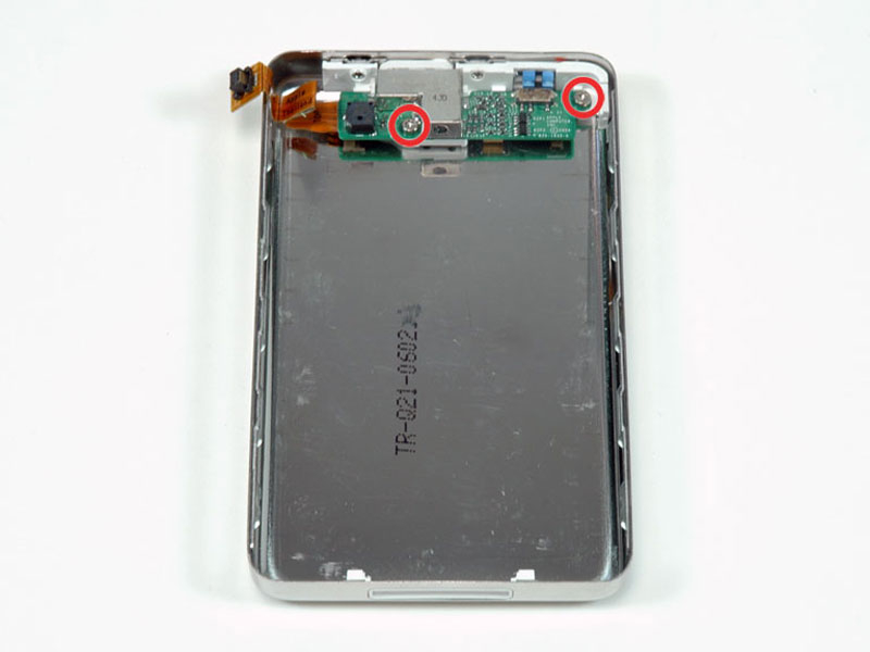

Add Note Edit Step 9 — Headphone Jack  ¶
  • Remove the 2 silver T6 Torx screws from the headphone jack.
Image #1

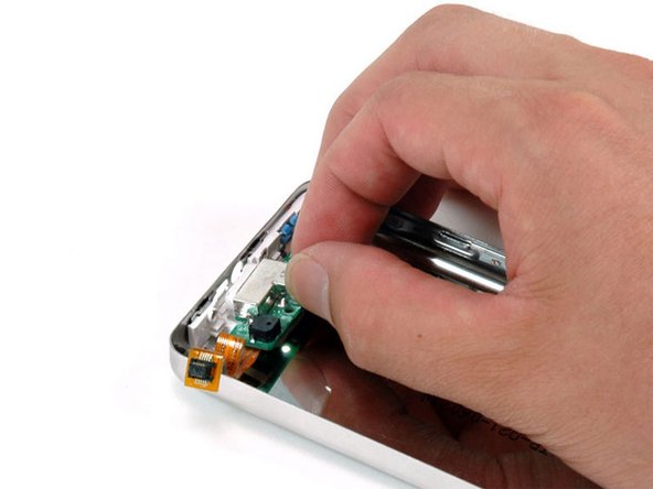

Add Note Edit Step 10  ¶
  • Grasp the headphone jack board and lift it out of the iPod.

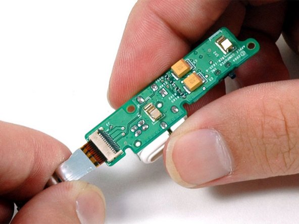

Add Note Edit Step 11  ¶
  • Turn the headphone jack board over.
  • Use the tip of your finger or a spudger to carefully flip up the black connector holding the headphone jack cable connector in place.

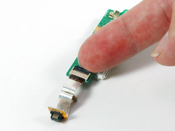

Image #1
Add Note Edit Step 12  ¶
  • Pull the orange headphone jack cable directly out of its connector.
