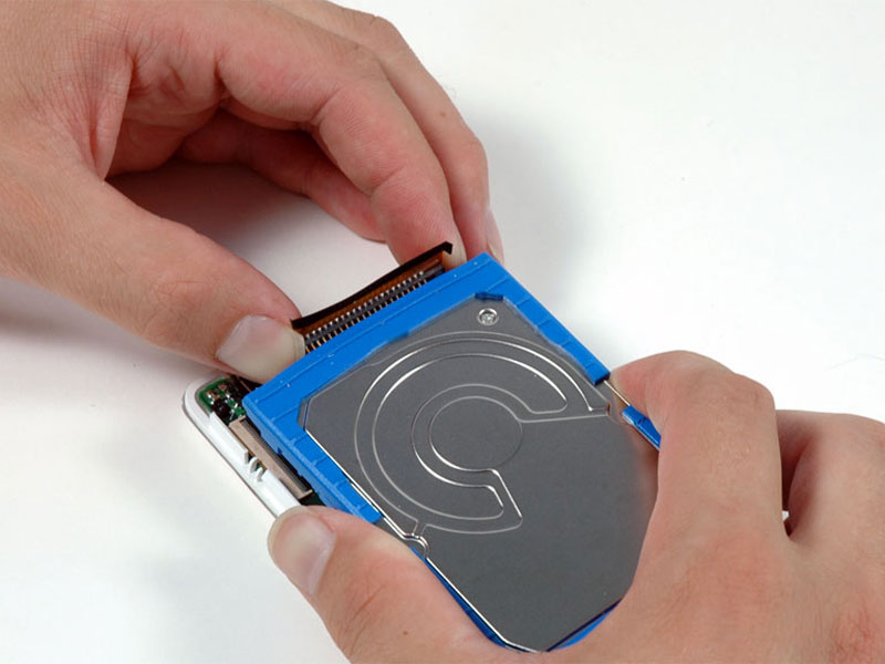

Add Note Edit Step 9 — Hard Drive  ¶
  • Grasp the hard drive with one hand and carefully disconnect the orange ribbon cable from the hard drive using your other hand.
  • If the cable doesn't come free easily, it may be helpful to gently wiggle the cable from side to side.
