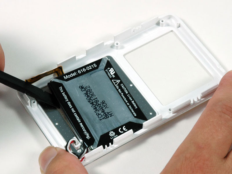

Add Note Edit Step 19 — Front Panel  ¶
  • Use a spudger to pry the battery off the front panel.
  • Lift the battery up and out of the iPod.
first image
Add Note Edit Step 20  ¶
  • Front panel remains.
