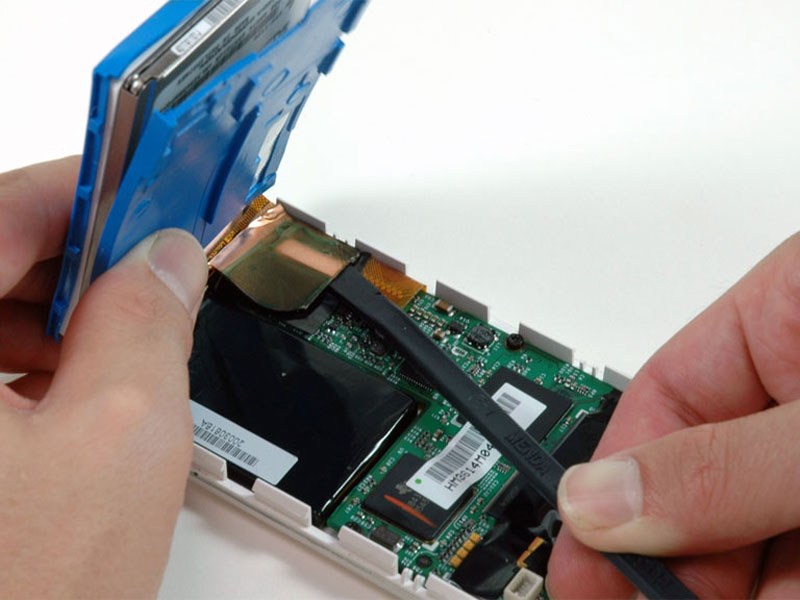

Add Note Edit Step 8 — Hard Drive Cable  ¶
  • Lift up the hard drive with one hand and carefully disconnect the hard drive ribbon from the logic board.
  • Lift the hard drive out of the iPod.
first image
