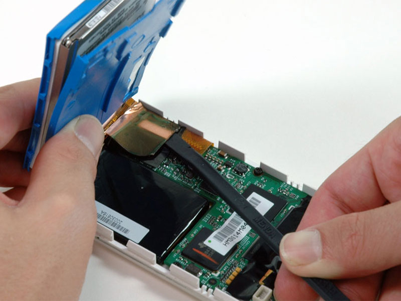

    • Lift up the hard drive with one hand and carefully disconnect the hard drive ribbon from the logic board.
    • Lift the hard drive out of the iPod.

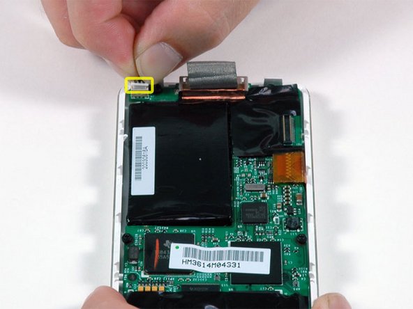

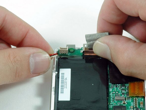

    • Carefully disconnect the white battery connector from the logic board. Be sure to pull only on the connector itself and not on the cables.
  7. iPod 3rd Generation Battery Replacement: step 7, image 1 of 1

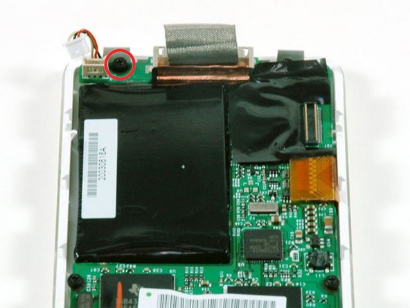

    • Removing the following screw isn't strictly necessary, but it will make the next step easier.
    • Remove the black T6 Torx screw from near the battery connector on the logic board.

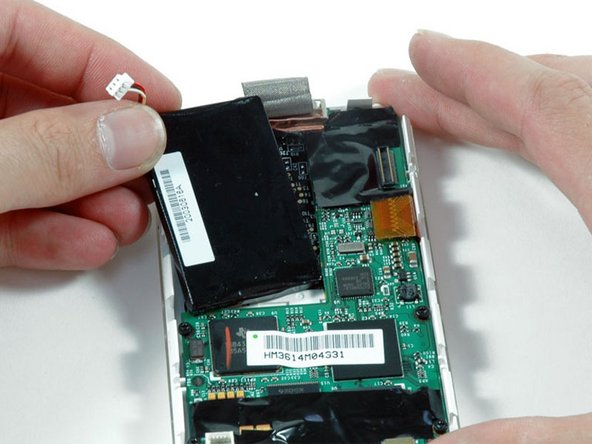

    • Carefully thread the battery cable around the end of the logic board. Be careful not to pull up on the logic board too much while freeing the battery cable.
  9. iPod 3rd Generation Battery Replacement: step 9, image 1 of 1
    • Lift the battery up and out of the iPod.

If you are real careful you don't have to remove the Torx screw to get the battery out.
beekersk8s - Reply
I found this quite easy. The tools worked great. I agree with Andy, if you push the tool into the groove, then lift or pry it up so the tip of the tool is down inside the back cover, you should be able to slide it across to pop the clips quite easily. Once you get the first two sides open, it goes quick.
I also did this without having to remove the Torx screw. It helped to lift the battery up a bit to give the wires a little slack, and then just feed them around the corner of the motherboard. Putting the new battery in, I just fed the wires around the corner, and used the opening tool to push them the final bit of the way around the corner.
