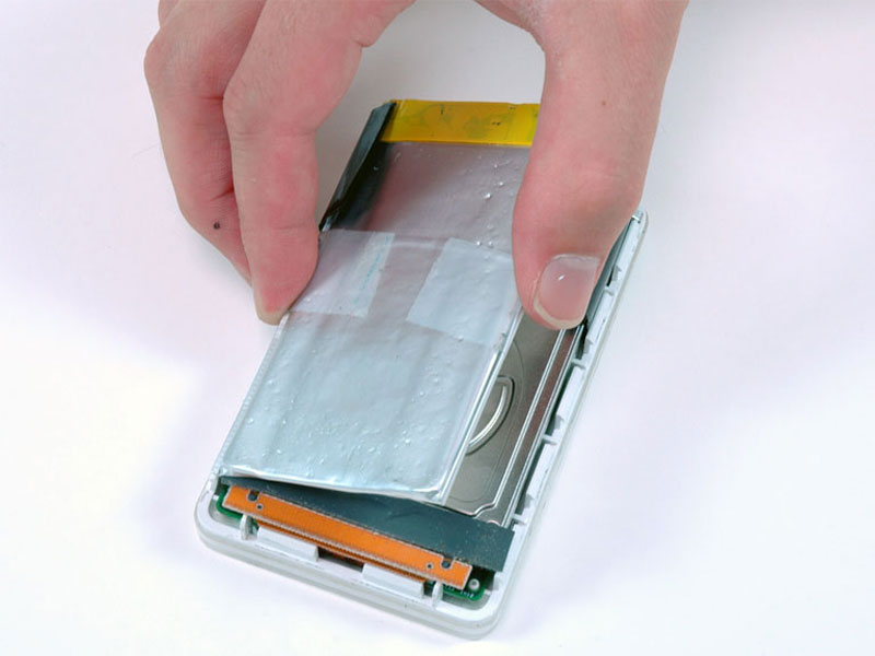

Add Note Edit Step 6 — Hard Drive  ¶
  • Lift the battery up from the adhesive holding it to the iPod.
  • Lay the battery next to the iPod (it is still connected to the logic board).
first image

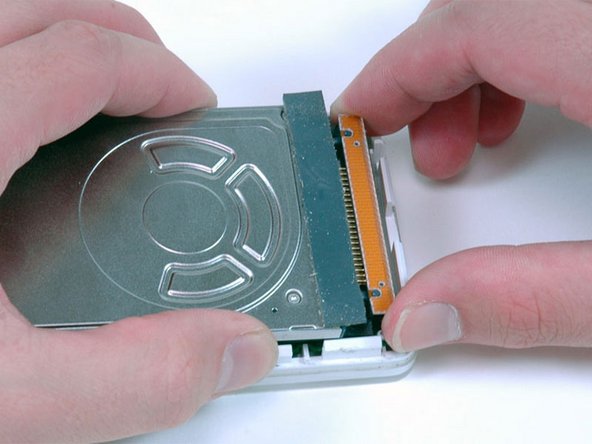

Add Note Edit Step 7  ¶
  • Carefully disconnect the orange ribbon cable from the hard drive.
  • If the cable doesn't come free easily, it may be helpful to gently wiggle the cable from side to side.
  • Lift the hard drive out of the iPod.
