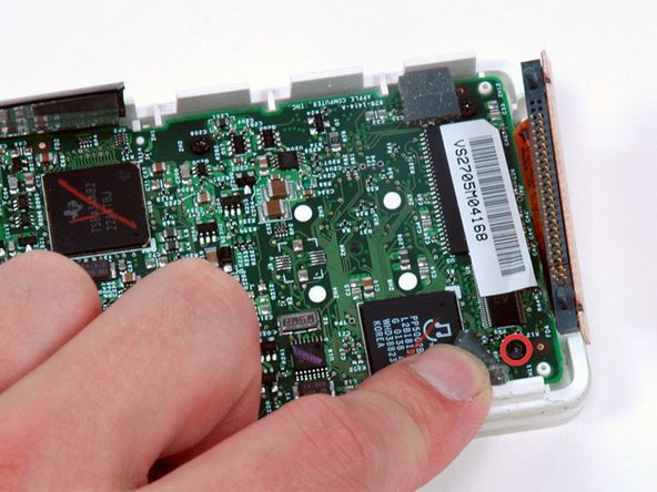

  • Peel up the gray rubber bumper near the hard drive ribbon to reveal the T6 Torx screw beneath.
  • Remove the newly revealed T6 Torx screw.

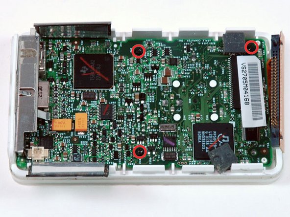

  • Remove the 3 remaining T6 Torx screws from the logic board.

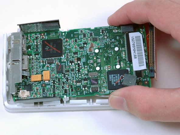

  • Slide the logic board away from the port end of the casing and lift it out of the iPod.

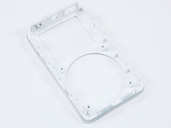

  • Front panel remains.
