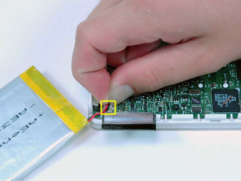

Add Note Edit Step 8 — Display  ¶
  • Carefully disconnect the white battery connector from the logic board. Be sure to pull only on the connector itself and not on the cables.
