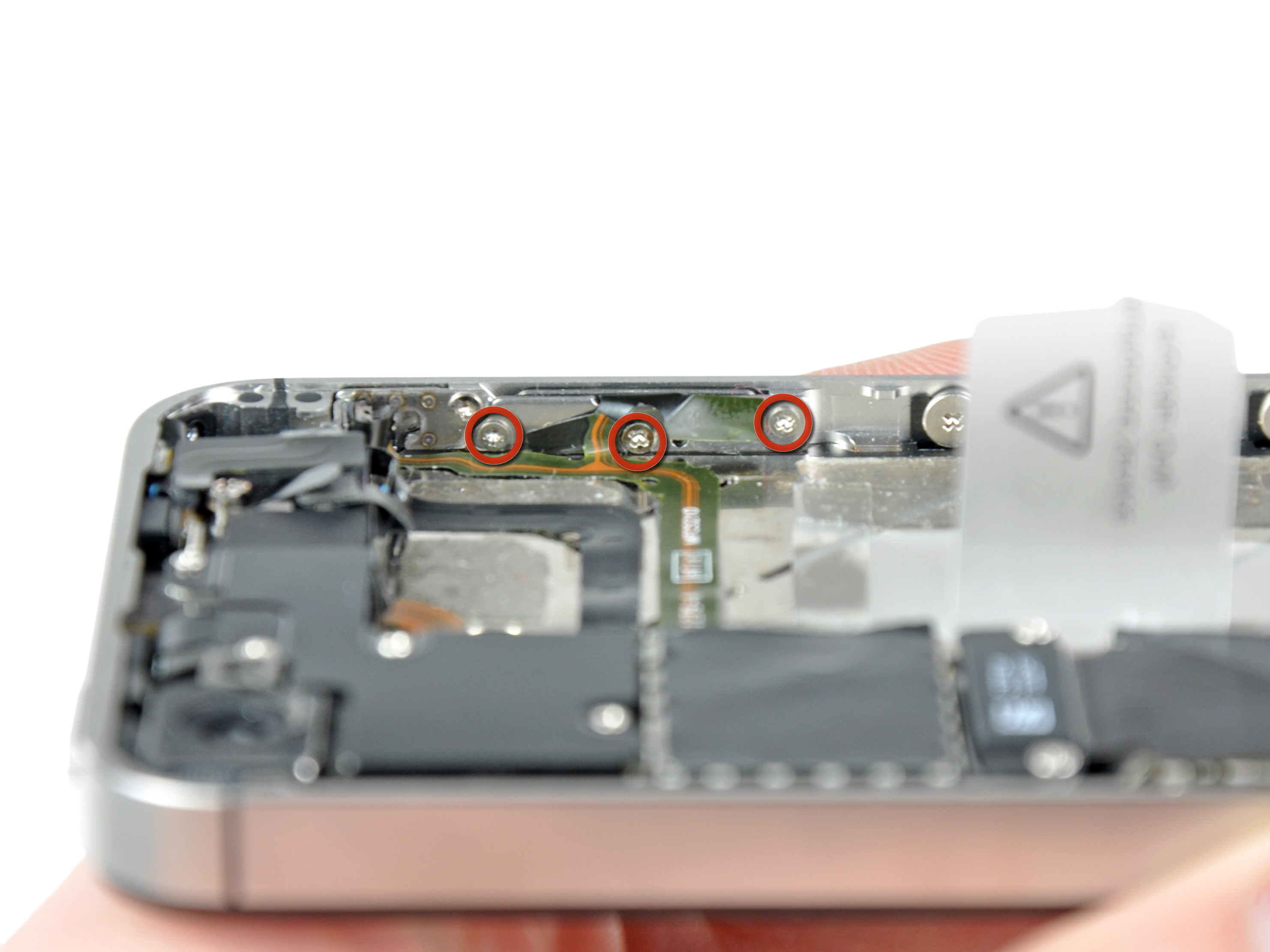

  10. iPhone 4S Volume Buttons Replacement, Volume Buttons: step 10, image 1 of 1
    • Remove the three 1.5 mm Phillips screws securing the volume button bracket to the outer case.
