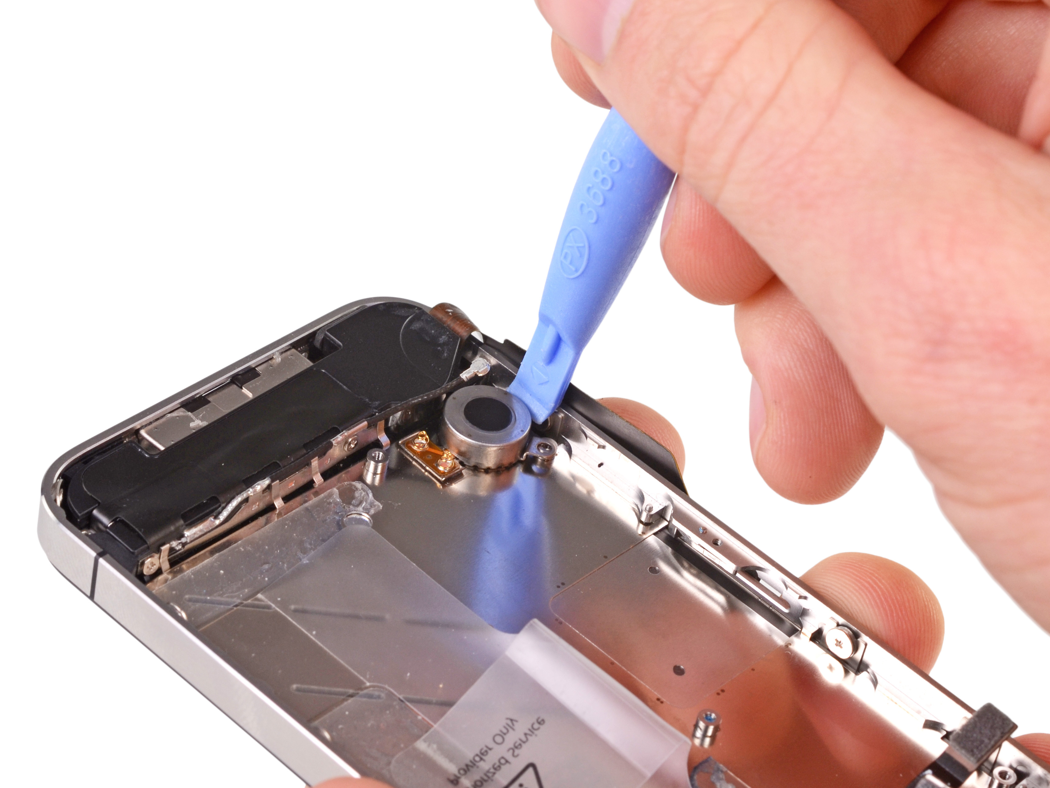

Add Note Edit Step 26 — Vibrator  ¶
  • Wedge the plastic opening tool between the vibrator and the side of the iPhone.
  • Pry the vibrator up to release it from the adhesive securing it to the iPhone.
  • Remove the vibrator.
