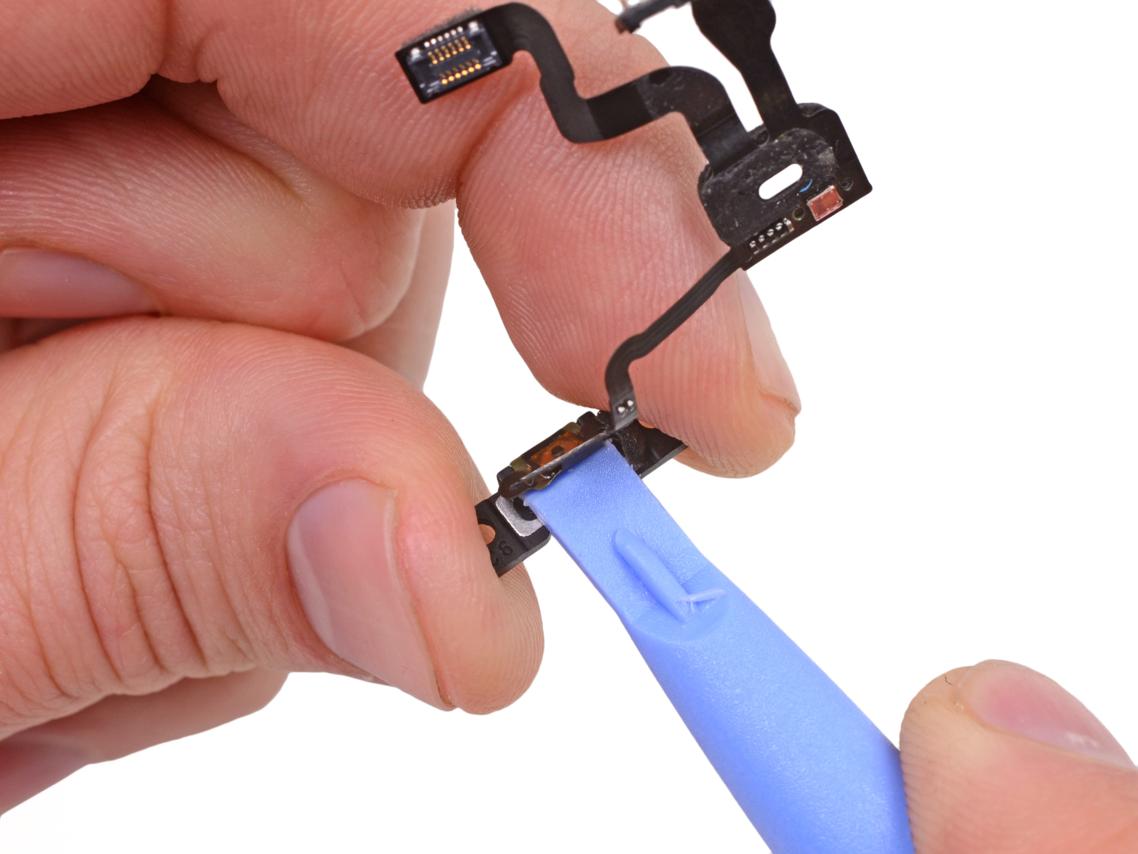

  32. iPhone 4S Power and Sensor Cable Replacement, Power and Sensor Cable Assembly: step 32, image 1 of 2 iPhone 4S Power and Sensor Cable Replacement, Power and Sensor Cable Assembly: step 32, image 2 of 2
    Tool used on this step:
    Buy
    • Use the edge of a plastic opening tool to pry the earpiece speaker off the adhesive securing it to the outer case. Note that the power button cable is glued to the the case as well, and will need to be pried up.
    • Use a pair of tweezers to unfold the earpiece speaker from its recess in the outer case.
    • Be careful not to tear the cable from the earpiece speaker. They are adhered together, and the cable is very delicate.
  33. iPhone 4S Power and Sensor Cable Replacement: step 33, image 1 of 2 iPhone 4S Power and Sensor Cable Replacement: step 33, image 2 of 2
    • Use the edge of plastic opening tool to gently move the top sensor assembly away from the outer case.
    • Gently pry the top sensor assembly off the outer case.
  34. iPhone 4S Power and Sensor Cable Replacement: step 34, image 1 of 3 iPhone 4S Power and Sensor Cable Replacement: step 34, image 2 of 3 iPhone 4S Power and Sensor Cable Replacement: step 34, image 3 of 3
    • Lift and remove the power and sensor cable assembly from the iPhone.
    • Be sure not to lose the small retainer clip located on the top sensor assembly.

  36. iPhone 4S Power and Sensor Cable Replacement, Power and Sensor Cable: step 36, image 1 of 1
    • Use the edge of a plastic opening tool to separate the power button contact from its plastic bracket.
  37. iPhone 4S Power and Sensor Cable Replacement: step 37, image 1 of 1
    • Power and sensor cable remains.
