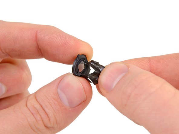

Image #1
Add Note Edit Step 40  ¶
  • Remove the home button from the home button gasket.
