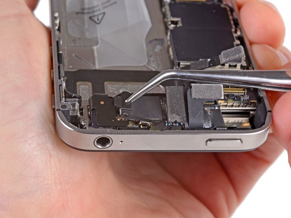

Add Note Edit Step 17 — Logic Board  ¶
  • Remove the five cables near the top of the logic board in the following order:
    • Headphone jack/volume button cable
    • Front facing camera cable
    • Digitizer cable
    • Display data cable
    • Power button cable (located underneath the headphone jack/volume button cable as shown in the second picture.)
  • To disconnect the cables, use the edge of a plastic opening tool to gently lift their connectors up and out of the sockets on the logic board.
  • Be careful not to break any of the small and delicate surface mount components as you disconnect the cables.
