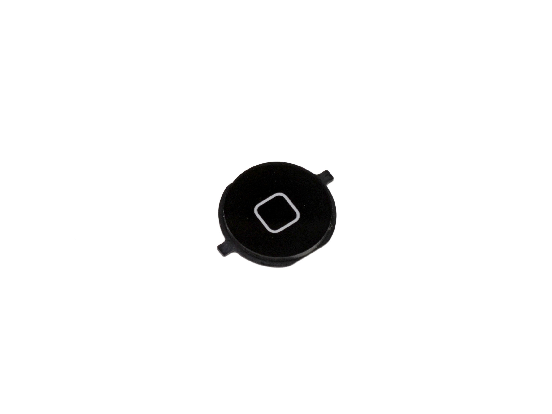

iPhone 4S Home Button Replacement
  1. iPhone 4S Home Button Replacement, Rear Panel: step 1, image 1 of 1
    • Before you begin, discharge your iPhone battery below 25%. A charged lithium-ion battery can catch fire and/or explode if accidentally punctured.
    • Power off your iPhone before beginning disassembly.
    • Remove the two 3.6 mm Pentalobe P2 screws next to the dock connector.

  44. iPhone 4S Home Button Replacement, Home Button Assembly: step 44, image 1 of 1
    • Use the edge of a plastic opening tool to gently peel the bottom right corner of the home button assembly from the display assembly.
  45. iPhone 4S Home Button Replacement: step 45, image 1 of 2 iPhone 4S Home Button Replacement: step 45, image 2 of 2
    Tool used on this step:
    Buy
    • Use a pair of tweezers to peel the home button assembly off the adhesive securing it to the display assembly.
    • Remove the home button assembly from the display assembly.
  46. iPhone 4S Home Button Replacement: step 46, image 1 of 1
    • Remove the home button from the home button gasket.
  47. iPhone 4S Home Button Replacement, Home Button: step 47, image 1 of 1
    • Home button remains.
