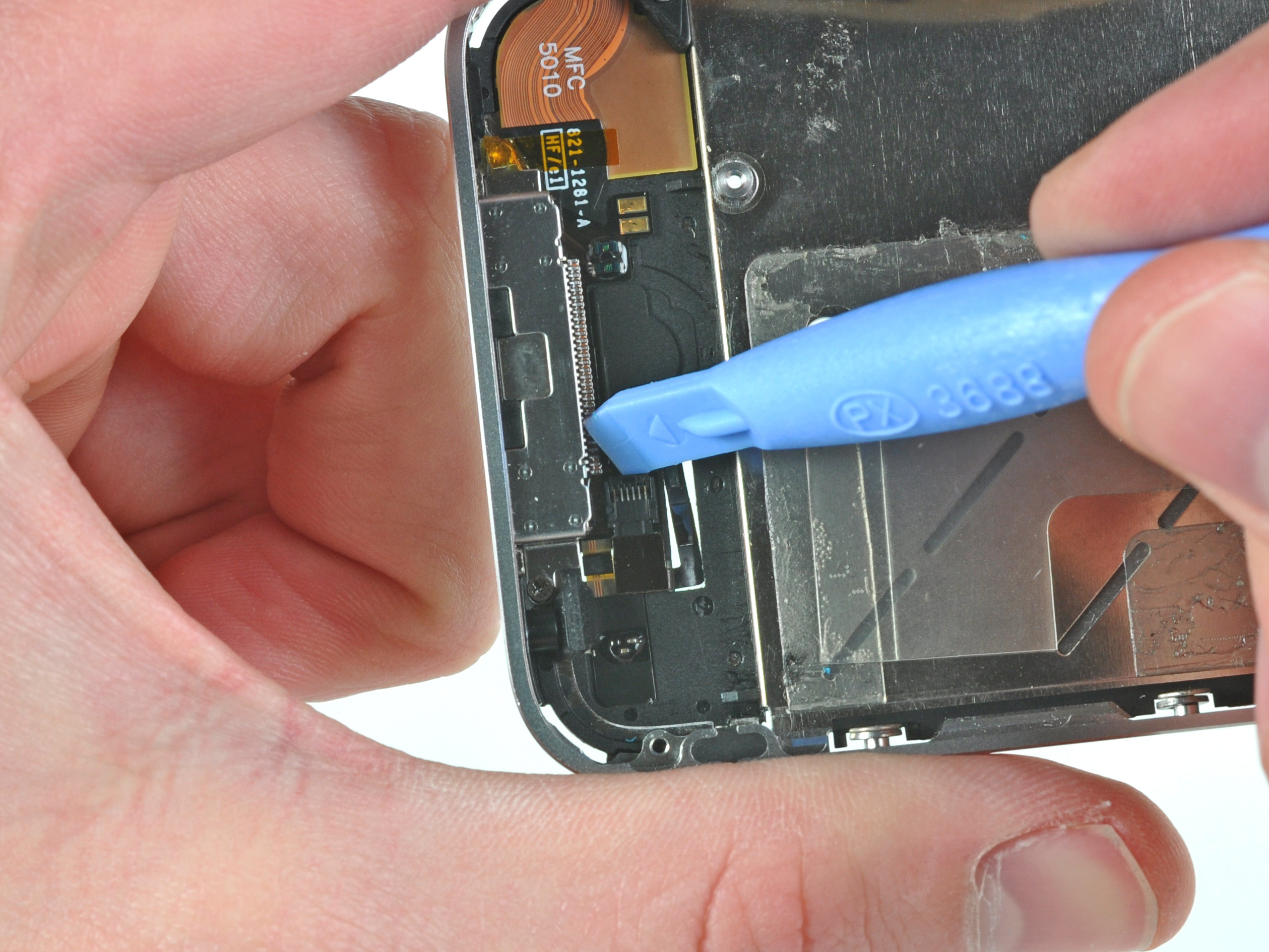

Add Note Edit Step 28  ¶
  • Remove the small plastic bracket that was installed under the screw closest to the dock connector cable.
