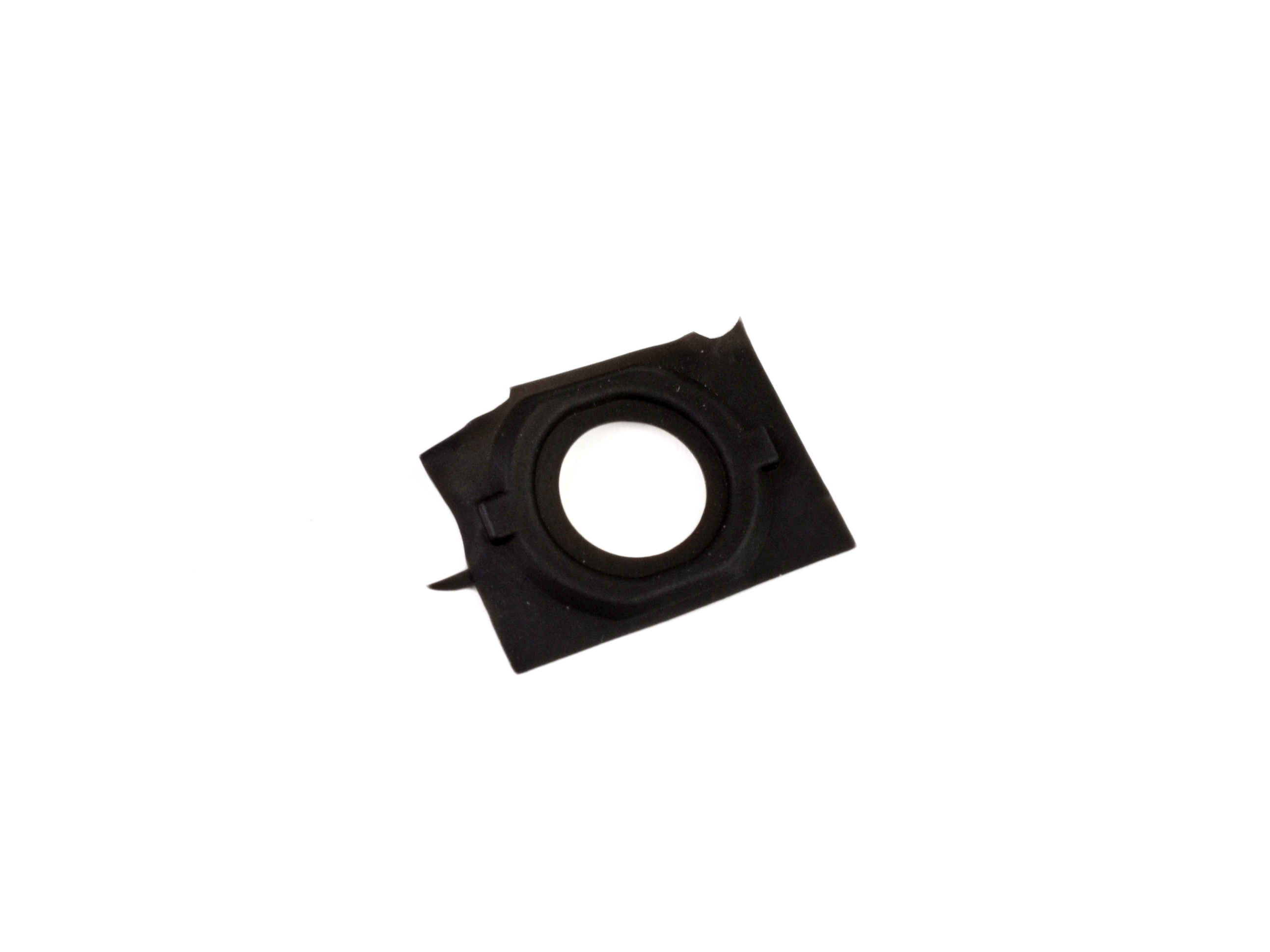

Installing iPhone 4S Home Button Gasket
Replace the home button gasket on your iPhone 4S.
  • Add Note x
  • x 4
Use this guide to replace the home button gasket.

Add Note Edit Step 39 — Home Button Assembly  ¶
  • Use the edge of a plastic opening tool to gently peel the bottom right corner of the home button assembly from the display assembly.
first image
thumb image 1
thumb image 2
Add Note Edit Step 40  ¶
  • Use a pair of tweezers to peel the home button assembly off the adhesive securing it to the display assembly.
  • Remove the home button assembly from the display assembly.
first image
Add Note Edit Step 41  ¶
  • Remove the home button from the home button gasket.
first image
Add Note Edit Step 42 — Home Button Gasket  ¶
  • Home button gasket remains.
