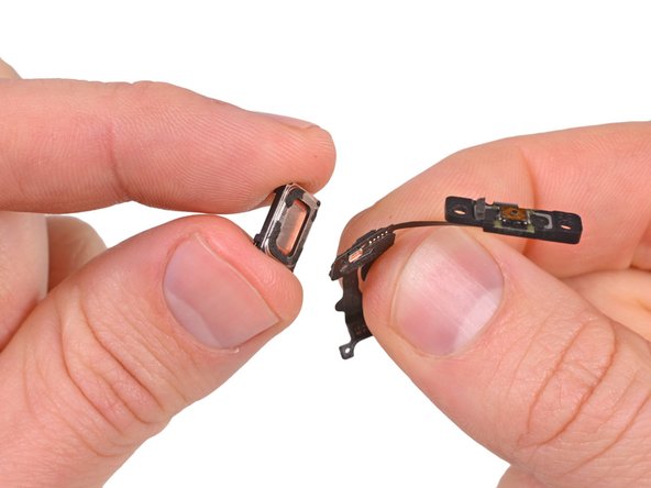

  30. iPhone 4S Earpiece Speaker Replacement, Power Button: step 30, image 1 of 2 iPhone 4S Earpiece Speaker Replacement, Power Button: step 30, image 2 of 2
    • Remove the two 1.6 mm Phillips screws securing the power button bracket to the outer case.
    • Take extra care with the display cables, which can prevent easy access to the right-hand screw. The cables are easily damaged.
    • Slightly pull the power button bracket away from the outer case.
  31. iPhone 4S Earpiece Speaker Replacement: step 31, image 1 of 2 iPhone 4S Earpiece Speaker Replacement: step 31, image 2 of 2
    Tool used on this step:
    Buy
    • Use a pair of tweezers to remove the power button from the iPhone.
    • During reassembly, take note of the correct orientation of the power button. The metal loop should be facing downwards and the outward edges should be on top.
  32. iPhone 4S Earpiece Speaker Replacement, Power and Sensor Cable Assembly: step 32, image 1 of 2 iPhone 4S Earpiece Speaker Replacement, Power and Sensor Cable Assembly: step 32, image 2 of 2
    Buy
    • Use the edge of a plastic opening tool to pry the earpiece speaker off the adhesive securing it to the outer case. Note that the power button cable is glued to the the case as well, and will need to be pried up.
    • Use a pair of tweezers to unfold the earpiece speaker from its recess in the outer case.
    • Be careful not to tear the cable from the earpiece speaker. They are adhered together, and the cable is very delicate.
  33. iPhone 4S Earpiece Speaker Replacement: step 33, image 1 of 2 iPhone 4S Earpiece Speaker Replacement: step 33, image 2 of 2
    • Use the edge of plastic opening tool to gently move the top sensor assembly away from the outer case.
    • Gently pry the top sensor assembly off the outer case.
  34. iPhone 4S Earpiece Speaker Replacement: step 34, image 1 of 3 iPhone 4S Earpiece Speaker Replacement: step 34, image 2 of 3 iPhone 4S Earpiece Speaker Replacement: step 34, image 3 of 3
    • Lift and remove the power and sensor cable assembly from the iPhone.
    • Be sure not to lose the small retainer clip located on the top sensor assembly.

    • Use the edge of a plastic opening tool to peel the earpiece speaker off the foam adhesive securing it to the iPhone.
    • If you wish to reuse the earpiece speaker, try not to tear the foam adhesive that secures it to the iPhone's case.
    • Remove the earpiece speaker.
  36. iPhone 4S Earpiece Speaker Replacement, Earpiece Speaker: step 36, image 1 of 1
    • Earpiece speaker remains.
