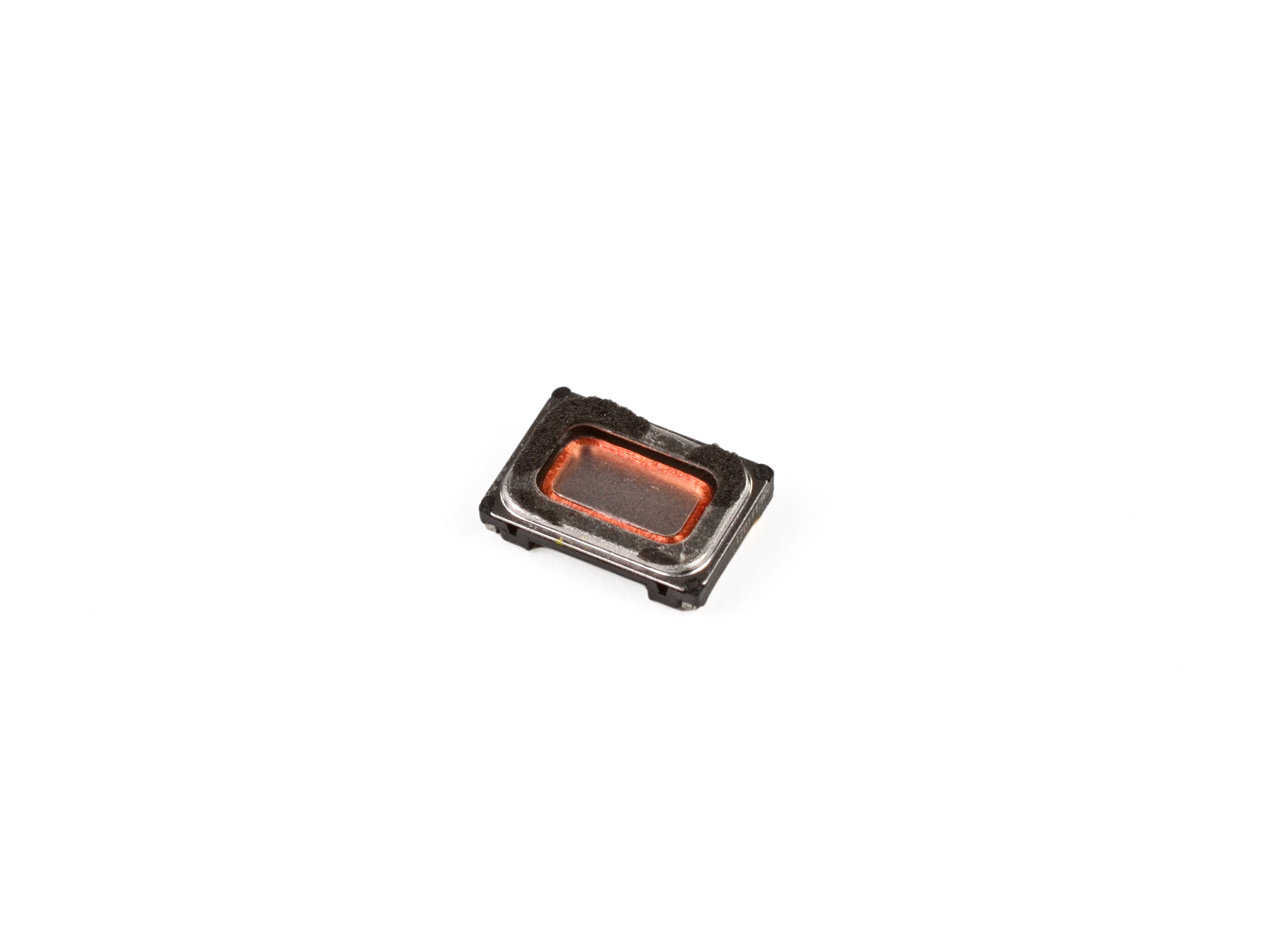

Installing iPhone 4S Earpiece Speaker
Replace a blown-out earpiece speaker in your iPhone 4S.
  • Add Note x
  • x 58
Use this guide to replace a blown-out earpiece speaker.
