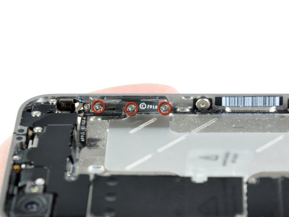

  8. iPhone 4 Volume Button Replacement: step 8, image 1 of 1
    • Remove the three Phillips screws securing the volume button bracket to the outer case.

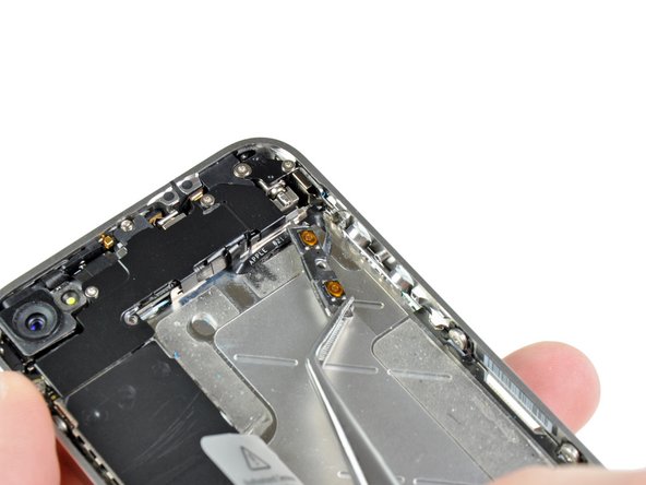

  9. iPhone 4 Volume Button Replacement: step 9, image 1 of 1
    • Use a pair of tweezers to gently pull the volume button bracket slightly away from the outer case.

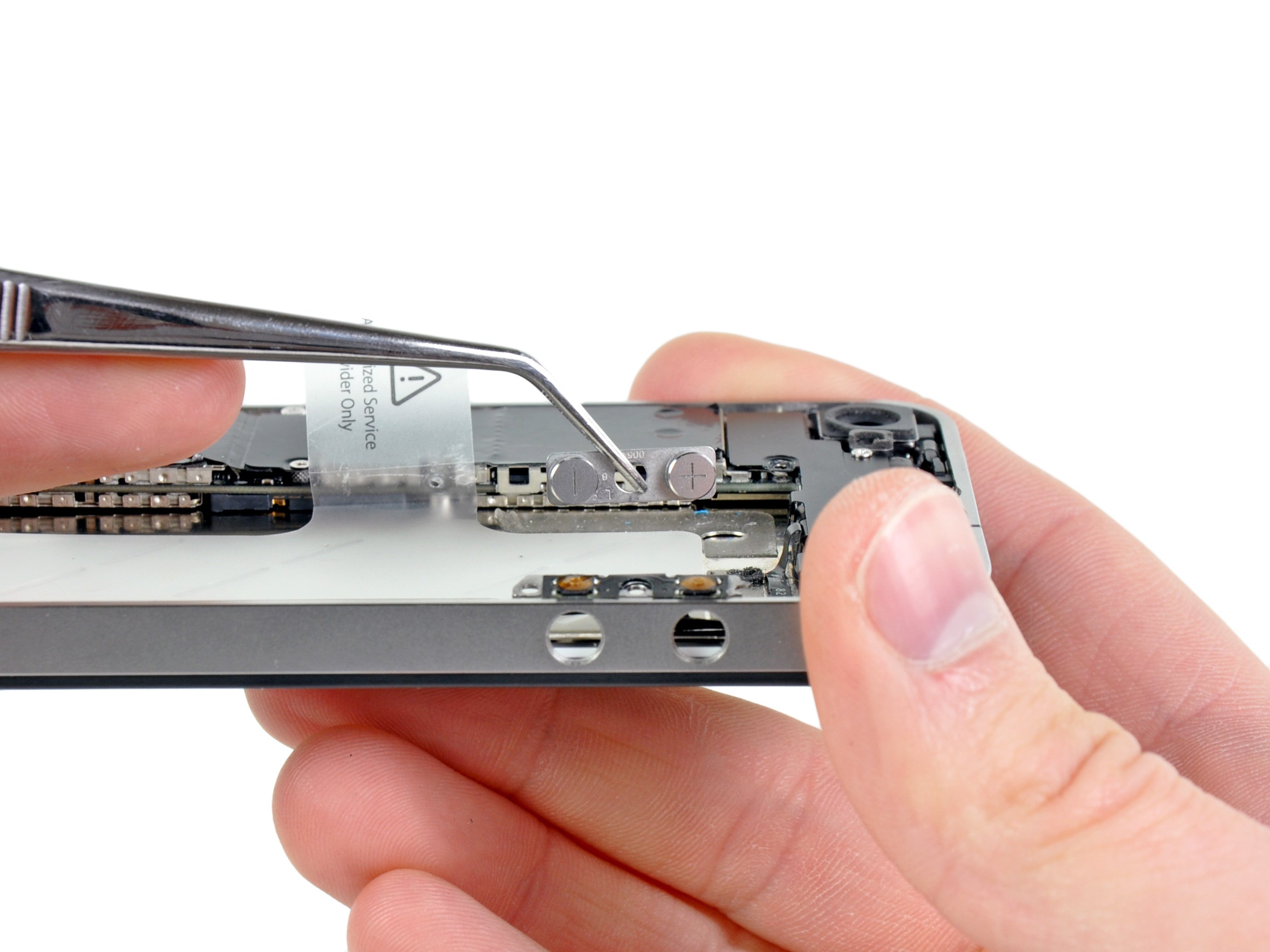

  10. iPhone 4 Volume Button Replacement: step 10, image 1 of 1
    • Remove the volume button from the iPhone.
