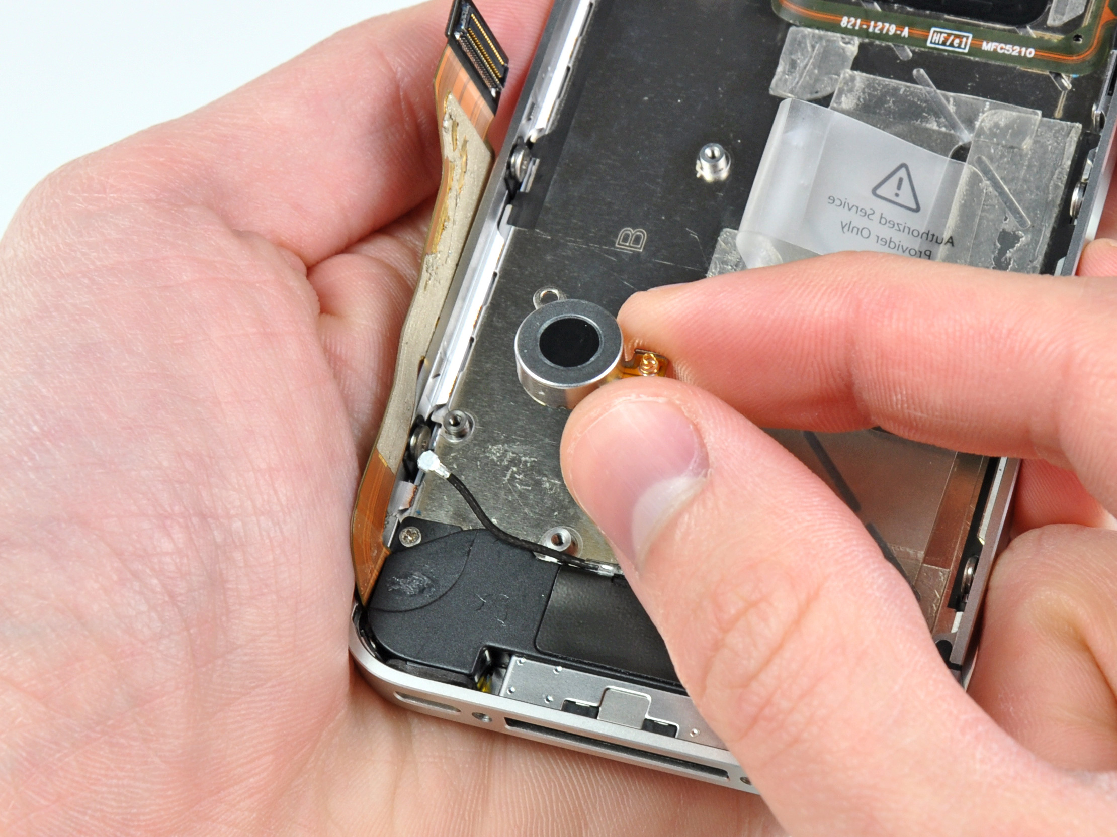

Add Note Edit Step 23 — Vibrator  ¶
  • Use the edge of a plastic opening tool to pry the vibrator off the adhesive securing it to the frame of the iPhone.
  • Remove the vibrator.
