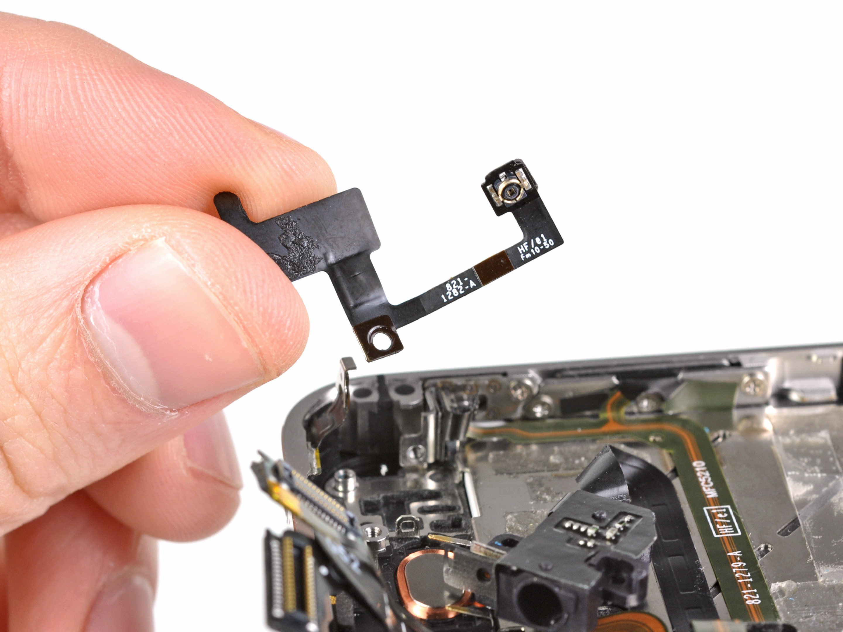

Add Note Edit Step 23 — Upper Antenna  ¶
  • Use the edge of a plastic opening tool to peel the upper antenna off the headphone jack.
first image
Add Note Edit Step 24  ¶
  • Remove the 2.4 mm Phillips screw next to the headphone jack.
first image
Add Note Edit Step 25  ¶
  • Use the edge of a plastic opening tool to gently move the top antenna contact away from the headphone jack.
first image
thumb image 1
thumb image 2
Add Note Edit Step 26  ¶
  • Use the edge of a plastic opening tool to peel the top microphone away from the outer case.
  • Pull the body of the headphone jack away from the top edge of the iPhone.
first image
Add Note Edit Step 27  ¶
  • Remove the 2.5 mm Phillips screw securing the upper antenna to the outer case.
first image
Add Note Edit Step 28  ¶
  • Remove the upper antenna from the iPhone.
  • Before reassembly, be sure to clean the metal-to-metal contact point on the upper antenna (not the mating halves of its connector) with a de-greaser such as windex or isopropyl alcohol. The oils on your fingers have the potential to cause wireless interference issues.
