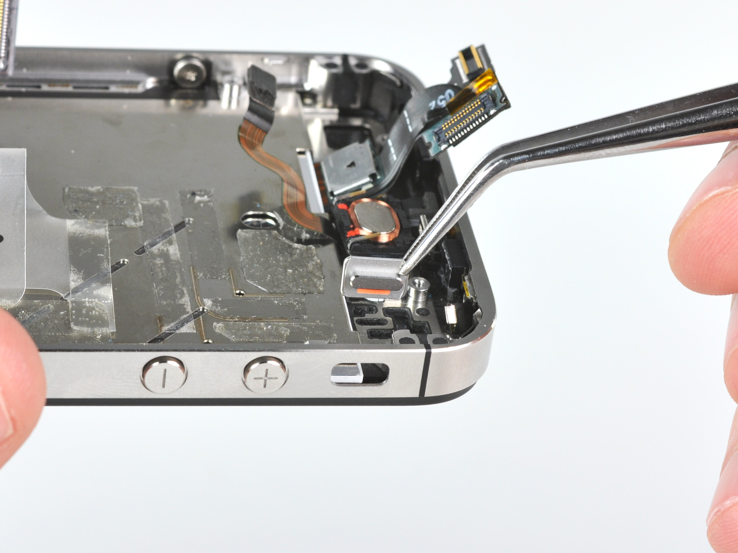

Add Note Edit Step 29 — Headphone Jack Cable  ¶
  • Remove the four 1.6 mm Phillips screws securing the volume button and silent switch brackets to the outer case.
first image
Add Note Edit Step 30  ¶
  • Carefully peel the headphone jack/volume button cables off the adhesive securing them to the rear case.
first image
Add Note Edit Step 31  ¶
  • Gently pull the silent switch bracket away from the outer case and peel its small ribbon cable off the inside of the iPhone.
first image
Add Note Edit Step 32  ¶
  • Remove the headphone jack cable from the iPhone.
first image
thumb image 1
thumb image 2
thumb image 3
Add Note Edit Step 33  ¶
  • If you are replacing the headphone jack cable, use the edge of a plastic opening tool to remove the steel brackets for the volume buttons and the silent switch.
  • Transfer these steel brackets to the new headphone jack cable.
first image
Add Note Edit Step 34 — Silent Switch  ¶
  • Use a pair of tweezers to remove the silent switch from the case of the iPhone.
  • During reassembly, the orange bar should be closest to the front of the iPhone when the silent switch is installed.
